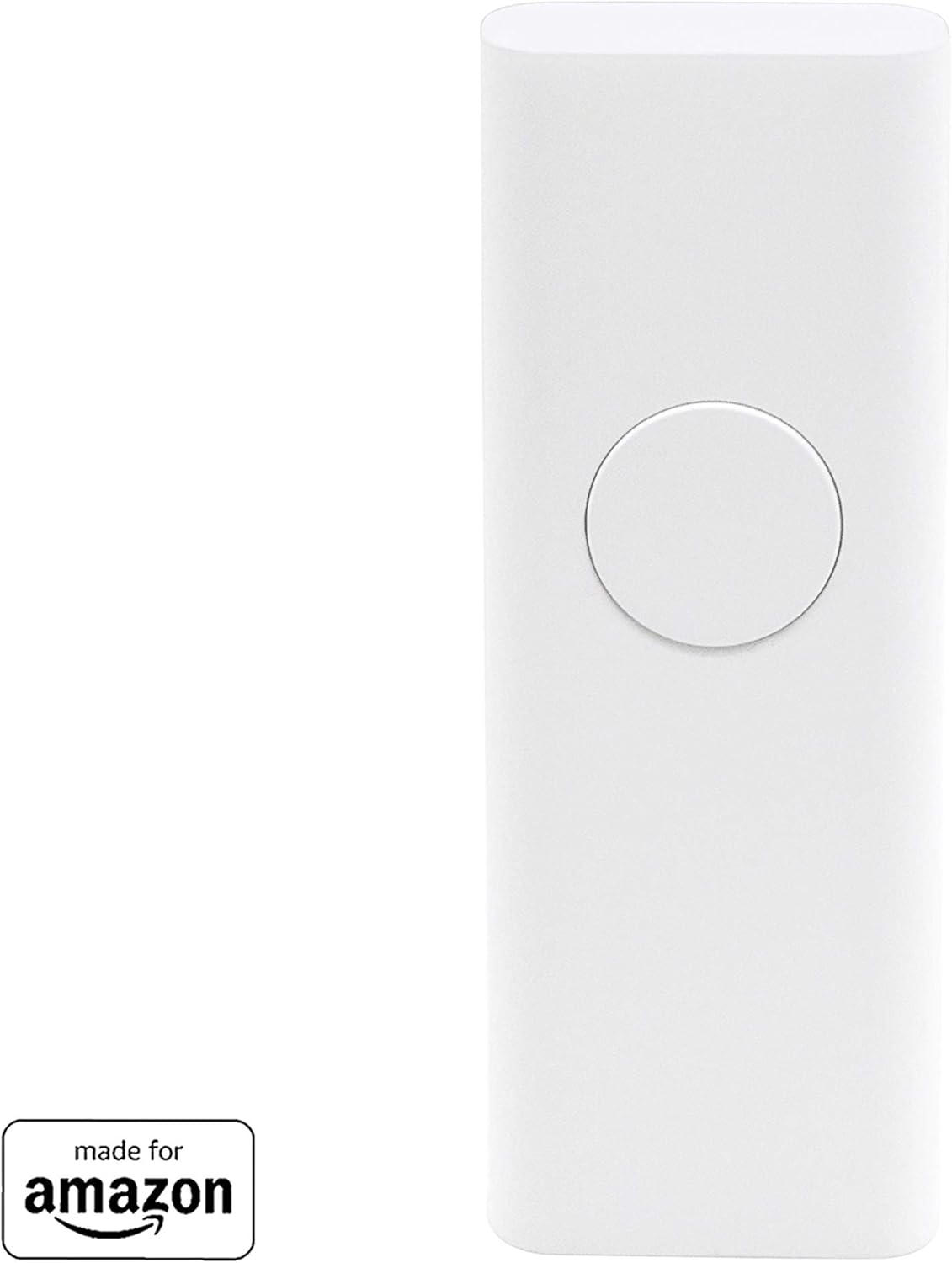

I bought one of the ThirdReality switches to control my gas fireplace where the switch is in an awkward location. I paired it right away yesterday and added the Generic Zigbee Switch as suggested in the Device list, however the switch did not work through HE, only when pressing the button.

Thanks @StephenH. This is Gen1 and I have a few Iris outlets that can be used as repeaters but they are not in use currently. I am pairing less than 10 ft from the hub and have also placed the switch right next to the during pairing mode. If I get it working it will be about 20 ft from the hub in the same room.
