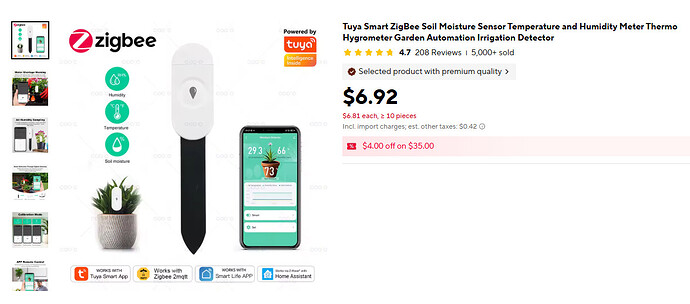

Ironically, I'm using the Tuya Soil moisture sensors from Ali Express with the Built-In Third Reality driver, as that is the only driver I have found that works with them correctly.
I initially tried the "Tuya Temperature Humidity Illuminance LCD Display with a Clock" driver, and while it worked somewhat, the readings were very erratic, and sometimes temperature didn't update. I tried all the different model selections besides auto detect, most of them didn't work at all.
The Third Reality driver gives me steady reporting of both humidity and temperature with the Tuya sensors. I graphed the moisture readings and it is a fairly smooth curve. With the kkossev Tuya driver, the humidity readings jumped around erratically with the Tuya moisture sensors.
These things are great! Free shipping if you buy two of them, and no import charges.
Can you please provide a link to the specific devices you ordered from Ali that work? There are dozens just like this when I do a search.
And which model Hubitat do you have them paired with?
I have four of them on my C8.
Dam, these Tuya Smart ZigBee Soil Moisture Sensor Temperature & Humidity Meter Thermo Hygrometer Garden Automation Irrigation Detector thingys are actually ridiculously cool.
Too bad there’s basically no decent Zigbee way to run them on a C7… which feels like buying a Ferrari and being told it only takes bicycle tires.

The older GEN1 will work on the C7. And they are much cheaper. Look at the ones shown above for less than $7.00.

- Will the sensors linked by @chrisbvt above in post #4 of this thread work with a C7?
- Are the sensors linked by @chrisbvt Zigbee 3.0?

All Tuya Zigbee gadgets that I have are working OK with my C-7 hub. In case of pairing problem - reboot your C-7 hub and pair the device at a close distance, immediately after the C-7 web UI becomes responsive.
All Tuya Zigbee devices are Zigbee 3.0. I think we are mixing Tuya and ThirdReality device pairing problems here, these are different.

Adding to this: I just received one of these devices, and the built-in "Third Reality Soil Sensor" driver works for me (on a C-7 and C-8 Pro). I did have to switch to this driver and then, as I said, run "Configure" (since the driver was not automatically detected, which will be changed in a future build). If anyone notices specific problems, please share them here!
I should also note that, unlike some other Third Reality devices I've used, I didn't have to re-pair this one after switching drivers for it to receive the configuration (so it doesn't seem to only listen when it wants to like their older[?] devices), but that certainly can't hurt, either.
