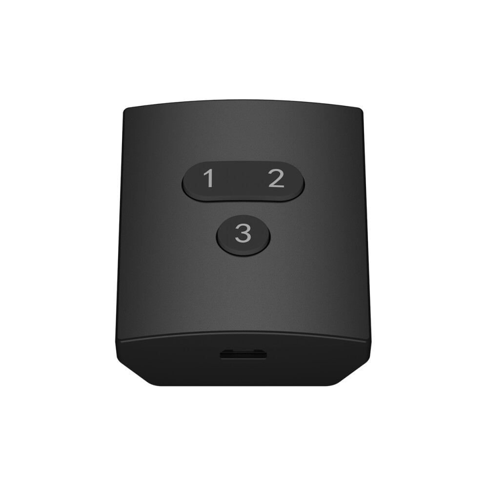

ThirdReality Smart Button ZB2 driver?
Hi! Does anyone have the (new in 2026, I believe) 3-button ThirdReality Smart Button ZB2? I'm trying to use it but can't find a driver that's happy with it. Any suggestions?
Thank you!

fingerprint profileId:"0104", endpointId:"01", inClusters:"0000,0001,0012,0004", outClusters:"0019,0005", model:"3RSB01085Z", manufacturer:"Third Reality, Inc", controllerType: "ZGB"
@joshr when you paired the device for a first time, was the HE inbuilt 'Third Reality Smart Button' driver selected automatically?
If not - select it manually and pair the device once again to your hub (without deleting it).
@kkossev Thanks for the suggestion! I just tried that. Now all 3 buttons register events -- but they all register as "button 1". Button 1 was held, button 1 was released, button 1 was pushed, etc. Regardless of which button I'm actually pushing.
I reluctantly tried Claude-based development, and got a working driver quickly. The abilities of tools like this are impressive, but I fear we have lost so much in the way of community by relying on them. Anyway, here is a working driver if anyone else wants:
