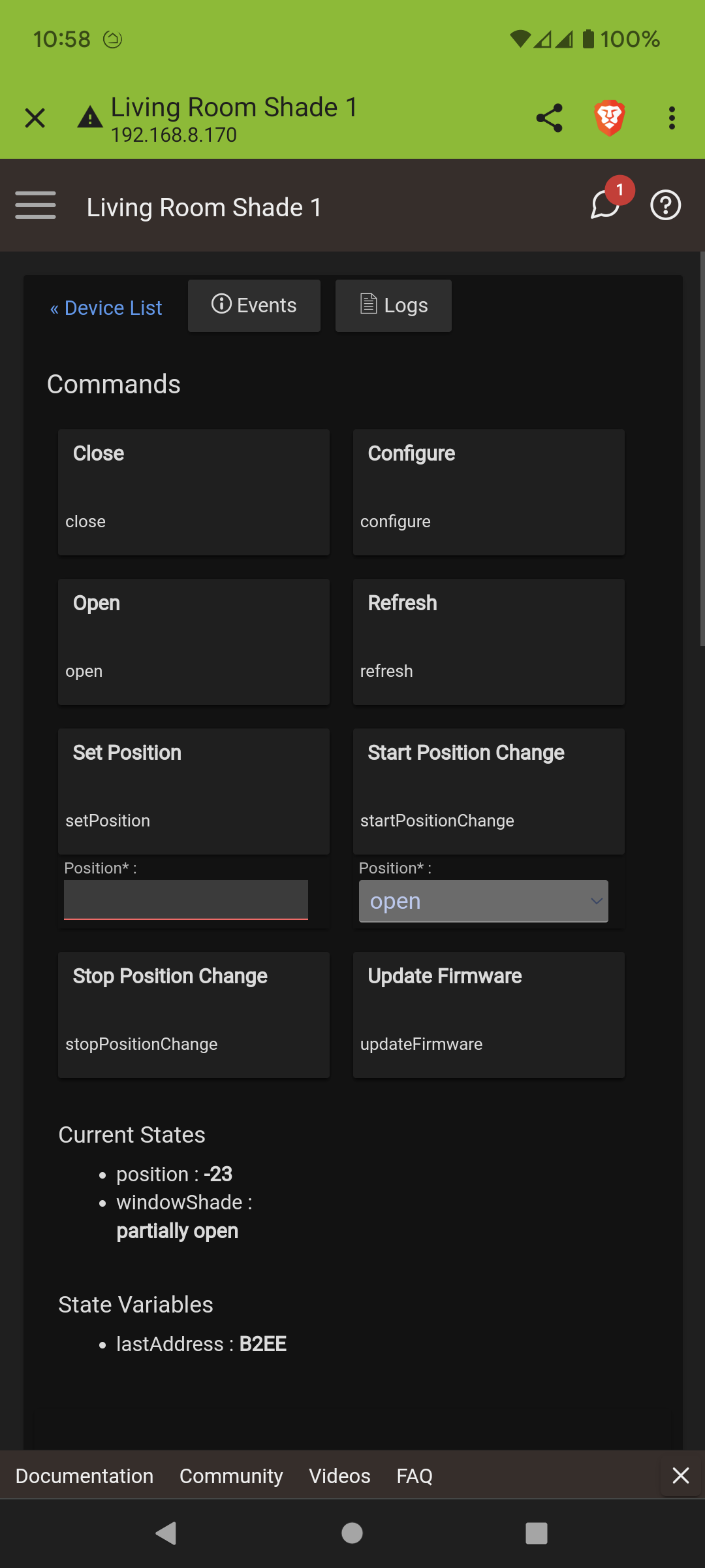

I am having a problem with my stop position change. This one shade refuses to work properly. The 0 position is 23% short of the actual closed position. I have tried every combination of settings in the device settings but I cannot get the zero position to equal the actual closed shade. Physically closed is -23. Can anybody help? I have removed and reset this shade multiple times but it keeps doing this. Attached is a picture. The shade is physically closed (Had to use the buttons on the shade itself.)

I was having a similar problem (not with C8 yet). I contacted Third Reality and they suggested that I update the firmware. It worked like a charm after I did that.
I created a post about how to use the remote. If firmware doesn't fix it, it's the only way to do it.
