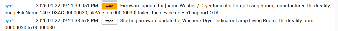

I have a C8 Pro running platform 2.4.3.176.
I was going to update my devices firmware and the Third Reality RGBW bult when I click the update firmware button it says that it is going to update to the newest firmware but then it gets canceled saying the device doesn't support OTA updates. Below is a screenshot of the logs.
Has anyone been able to do OTA updates on these devices. If so any tips on how to get this to work?

Now I keep getting the in the logs. I have done a shutdown and a reboot and neither has stopped this. It comes sometimes a minute apart and sometimes three or four minutes apart. @mike.maxwell any ideas on how to stop this?
Edit 2: I done a restore from a cloud backup and then also rebooted with a database rebuild and nothing has stopped the "warn" log entry.
I also updated the hub to firmware 2.4.3.177 hoping it might reset something on startup. That didn't work either.
I went in and changed the driver to device, cleared everything out, applied a different driver and still getting the warn message. So went back to original Third Reality Driver.
