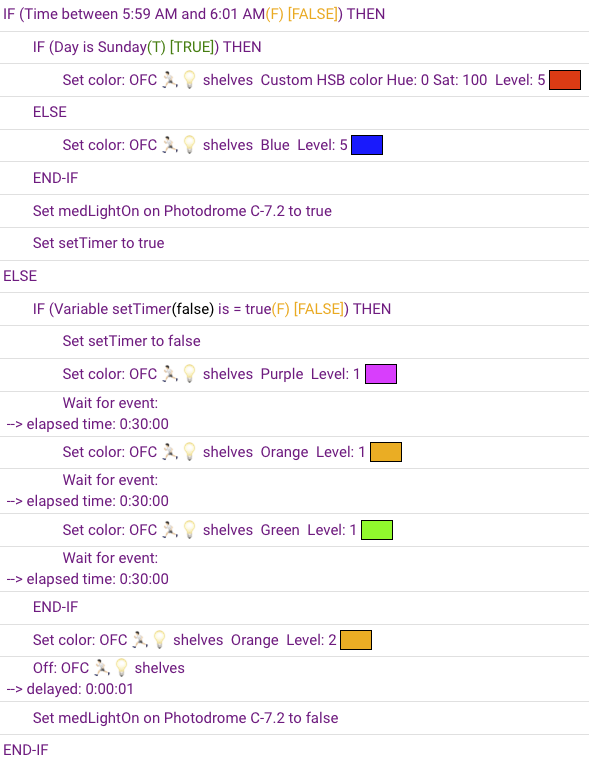

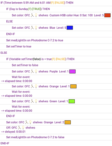

I remember having some color related issues, but don't recall what exactly the problem was. I did have to set red using a custom color. The other colors worked with Set Color. Never found a solution to the 12 hour reset.
For what it's worth, this is what my RM script looks like.
