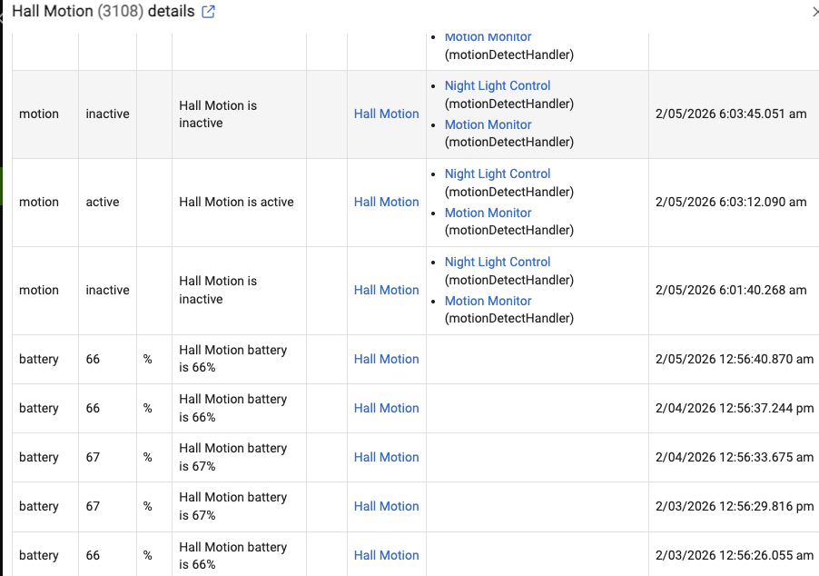

I have a couple of these that are doing something weird. They work fine as far as motion detection and triggering my automations. But there is gaps in the events list. Here is a screen shot of one of them. It shows no motion events for several days but it definitely sees motion many times every day. And again it triggers my automation. This is no big deal, just curious as to why it doesn't show the events. Thinking about it some more, it's like it erases all the motion events whenever it reports battery level.
There appears to be some additional motion events above what is shown in your screen shot. Could it be that the ones not shown are more than the event limit? What is your event limit? I think the default is 20.
AAAH... I think I understand now. The event limit is per event type. I thought the limit applied to all events as a total. Makes sense now. Thanks.
