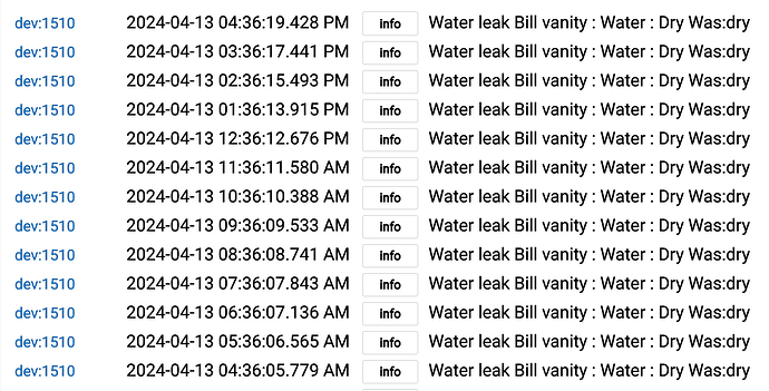

I'm seeing "dry" every hour. I'll watch it until my device activity check report at 8 am. The Third Reality driver seems to work well enough. Reports battery remaining, wet / dry, and not spamming the logs.

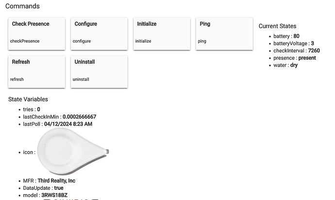

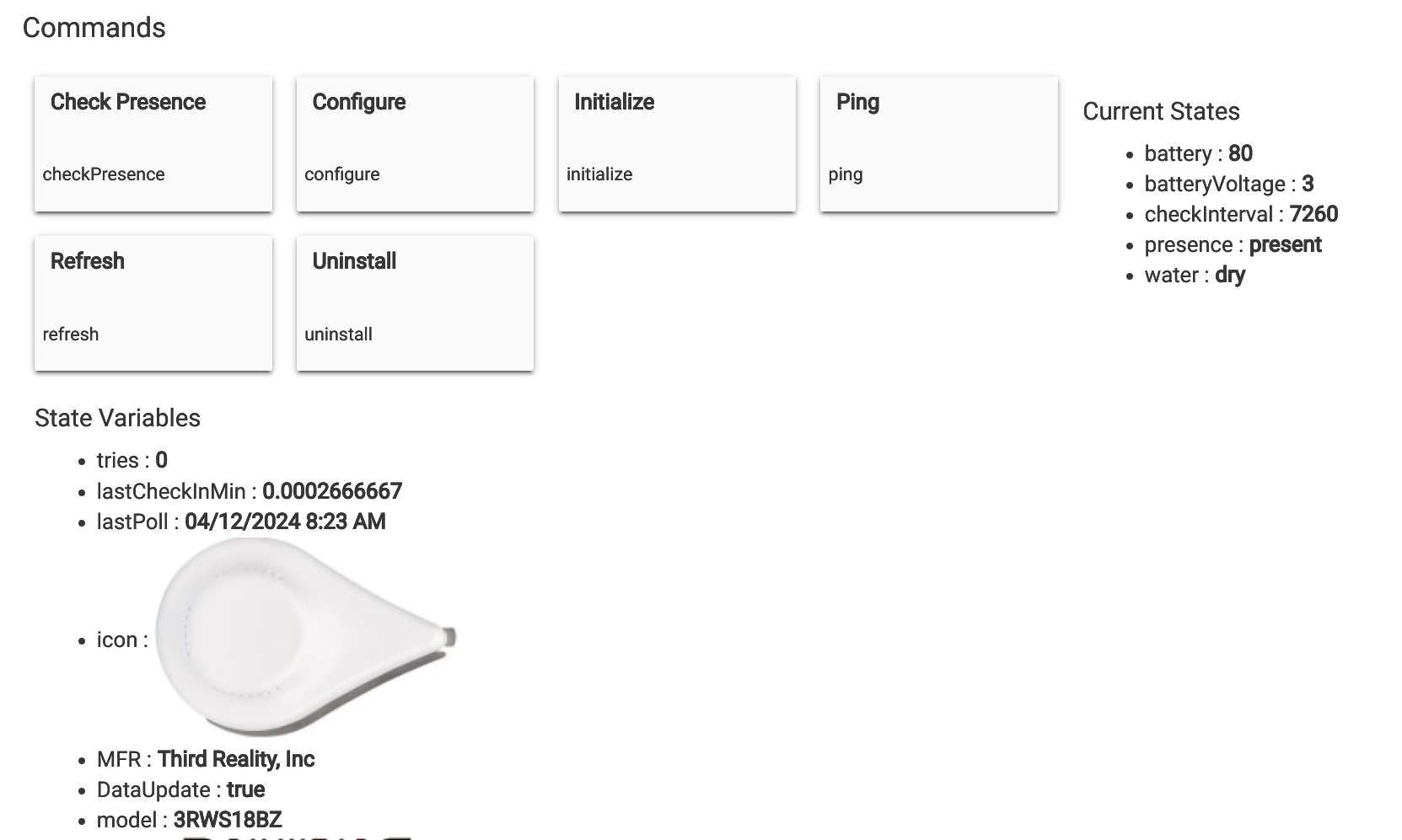

With the Third Reality driver I'm not seeing a battery report. However, they log "water" wet/dry hourly which satisfies device activity check. On the device page battery and voltage are reported. I have them set up in dashboard tiles and battery as well as wet/dry is displayed. Additionally, battery seems to increment in 10% intervals, five are at 80, one at 90 and one at 100 which seems reasonable based on install date. The good news is they don't all read 100.
This is the way I opted to set them up. I have converted all seven of mine Which have the new firmware.

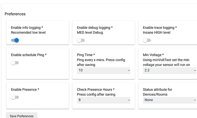

FYI the community driver "Third Reality water sensor" reports "water" wet or dry every hour which satisfies device activity check. I'm not seeing anything else in the logs.
I’ve only given a cursory look at the code but believe this is the result of the community driver polling the device, not the device reporting on its own, in which case there is no benefit using this driver over using Device Activity Check to issue a Refresh request to the built in driver (I use a 1 day interval).
I tried both ways, no idea which has less effect on battery life. I'm going to assume that a proper driver will surface and we can all profit from that skillful generous person.
