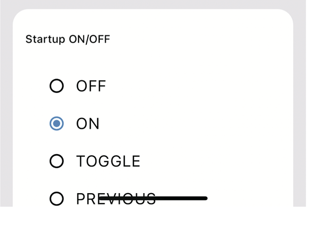

Is there a way to set up configure the Third Reality ZL1 bulbs to not turn on when power has been restored to the bulb? The documentation (see attached) indicates the function is there when using the Third Reality hub, but I don't see this configuration in Hubitat. Also, is there a way to update the bulb's firmware?
I just found this driver works with Third Reality. in another discussion thread about them not returning power state correctly. This driver works for power state with Third Reality Bulbs.
