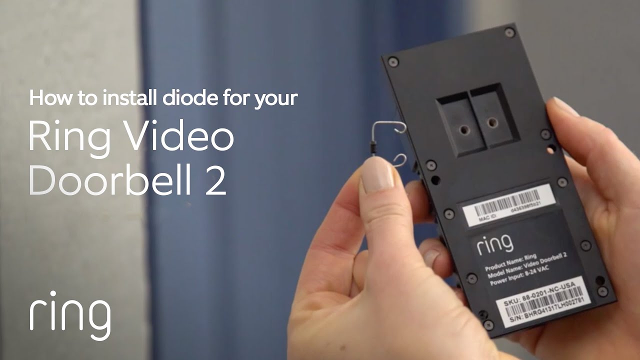

The diode goes across the terminals like so... Then a doorbell wire to each terminal. I did this as a matter of course during installation. Didn't even think about it. Works fine. (direction of the diode doesn't matter) (Edited, thought I had posted it)

Regardless, my chime is not digital, so based on the Ring video, the diode should not be used for the Reolink. Reolink instructions to use an existing doorbell CHIME don't even mention the diode.
