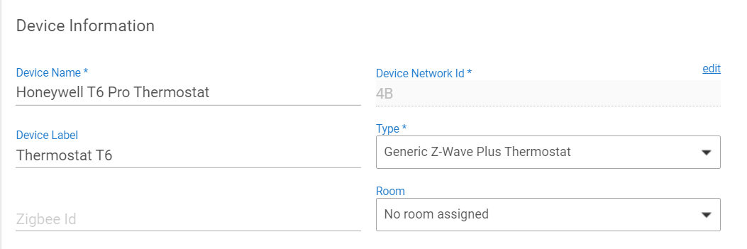

Post a couple screenshots of the device page for your thermostat. Include the section of the page that shows what driver the thermostat is using (lower down on the Device page).

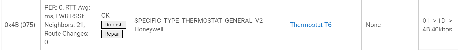

Lastly, go to you Z-Wave Details page and take screenshot of the thermostat - will look something like this:

Sure, done.
