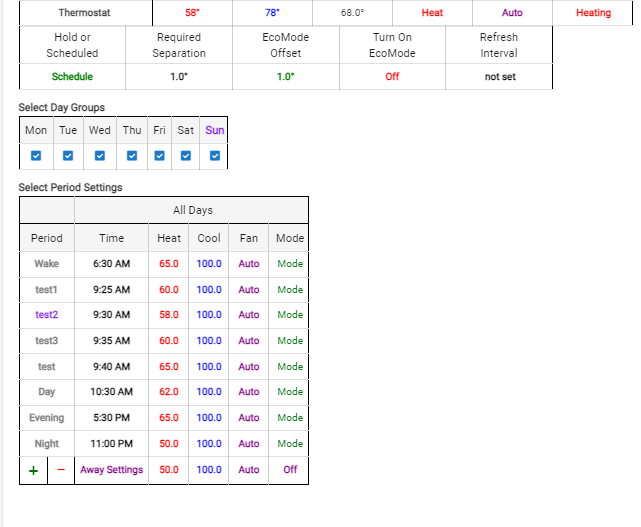

Several topics in this thread, so please tell us what issue you have specifically. Please turn on logging for Thermostat Scheduler so you can show us the problem you are having. Also, please post the setup page for Thermostat Scheduler.

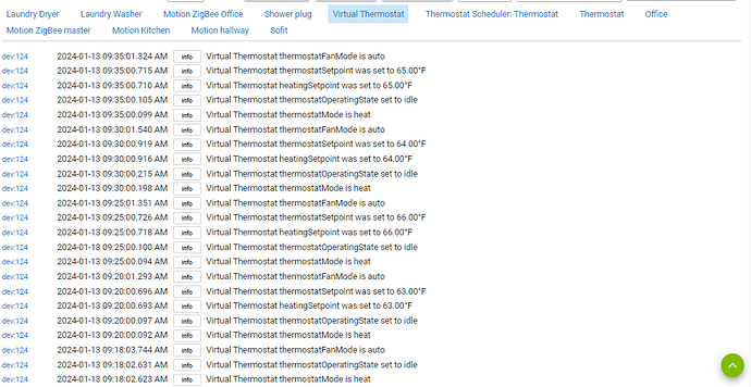

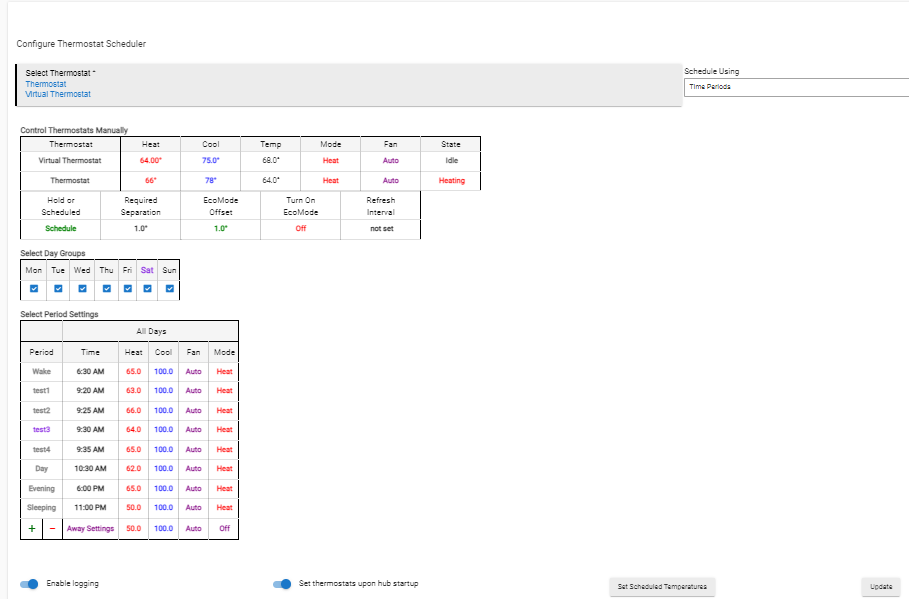

I have set up a few test time changes.
You can see in the Schedule at 9:30 the temp should have changed to 64.

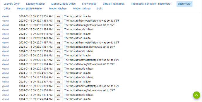

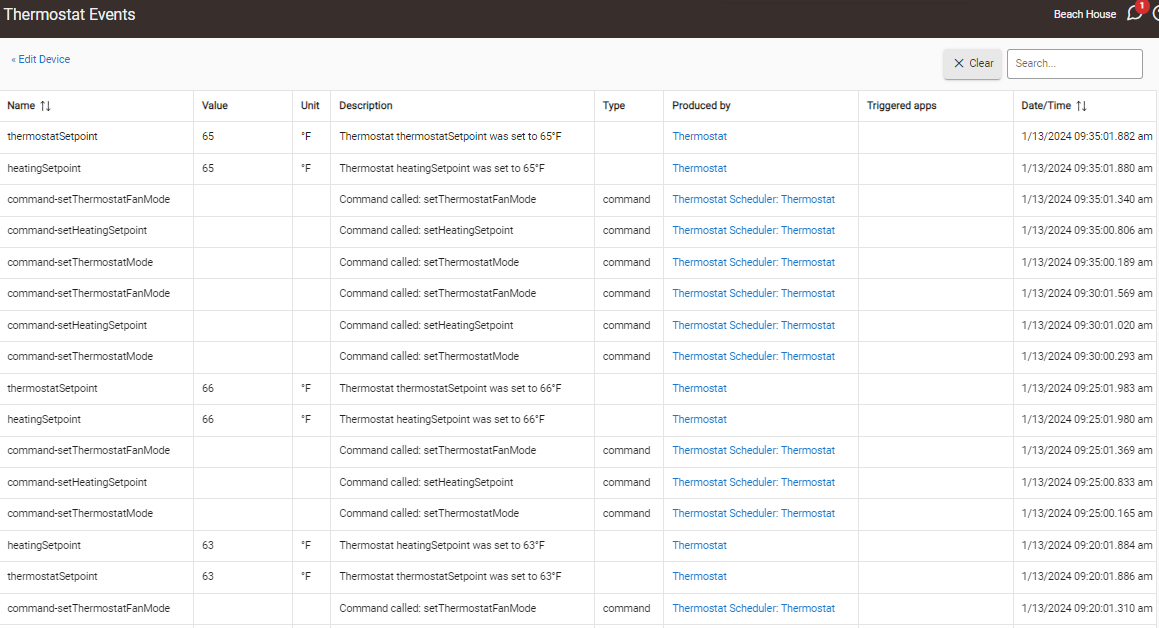

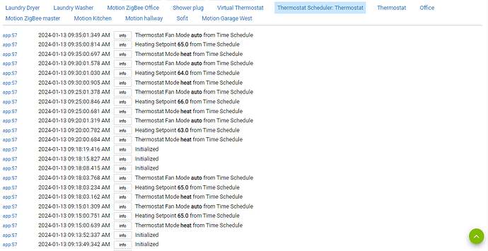

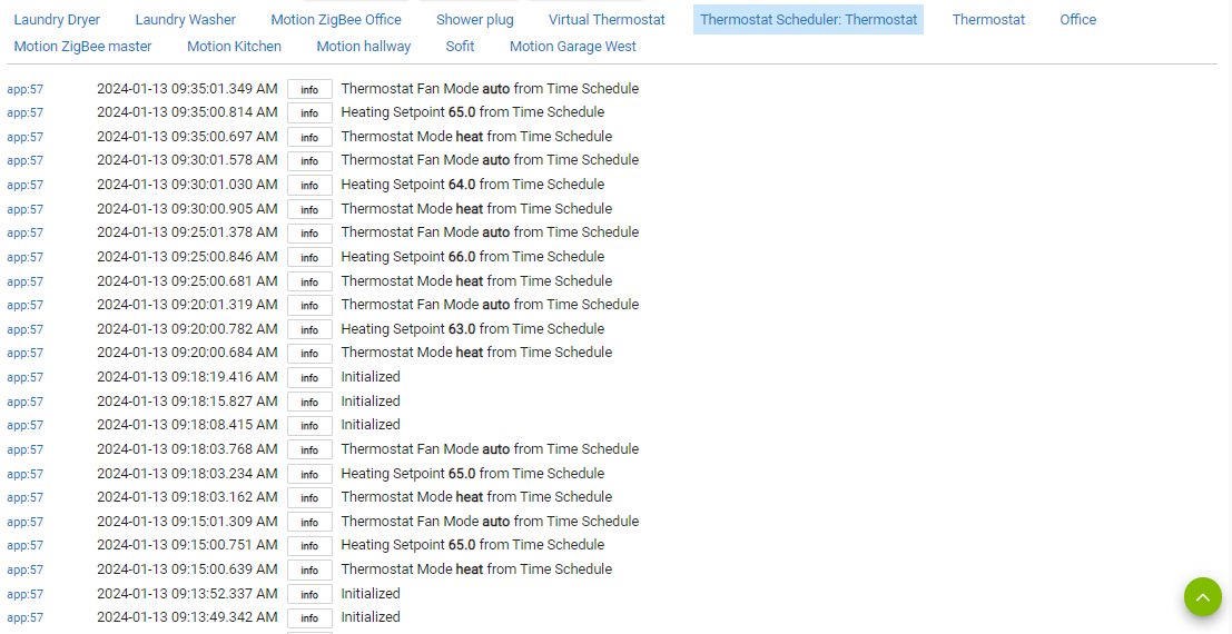

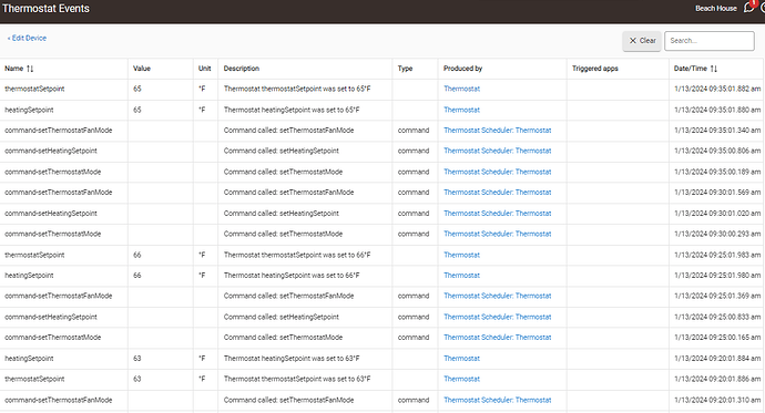

The logs show only the virtual thermostat and Schedule changed.
The thermostat did not.
So evidently this is some issue with the Thermostat device, correct? The logs show the app setting to 64 at 9:30, but not Thermostat, right?
Is this a CT100/CT101 thermostat?? If so, remove all of the settings in the Mode column of Thermostat Scheduler, and see if that fixes the problem. You don't need those mode settings at all, and those were the previous source of the problem with this thermostat. I thought the CT101 had been fixed, but maybe not. Are you on the latest release, 2.3.7?

I set up the Thermostat Scheduler as you suggested and it looks like the time/temp changes are happening properly now.
