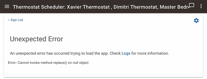

When I try to access my Thermostat Scheduler app, I get the following.
Could this be an issue in the latest version (I’m on 2.2.2.122), or is there something that I need to do?
Screenshot:
Log:
errorjava.lang.NullPointerException: Cannot invoke method replace() on null object on line 1145 (mainPage)
Probably. Upgrade to 2.2.2.123.
Yup. That did it! I didn’t realize there was already an update! I understand why now though...
Thanks!
Sorry about that. I forgot that not all thermostat drivers publish their list of fan modes, and that's what bit you.
Ah! No worries. We are all human, and the issue was fixed super quickly! Thanks for that!
