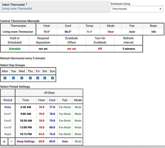

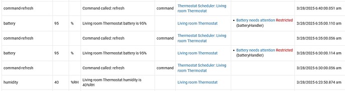

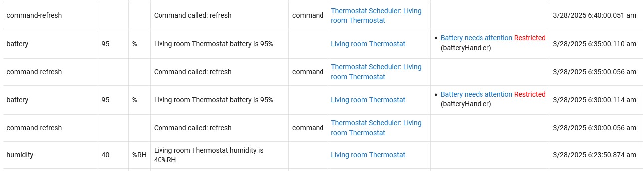

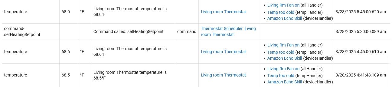

Thermostat scheduler has been working for me for a long time. However last week I changed the Wake Time from 5:30am to 6:30am. It has not made the wake change since then. I have had to make the change manually. The logs show that it sets it to the night setting at 5:30 but there is no activity other than a refresh at 6:30. I have rebooted the hub with no change in the issue and the hub is a c-8 running 2.4.0.151.

For anyone that searches for this issue, I figured it out, and it was user error. When I changed the wake time apparently I did NOT click the DONE button. After not getting any replies and looking at several other posts I figured that it would not hurt to try going back and doing it again. Well Thermostat Scheduler has followed the new schedule for the past two days. Problem solved.
