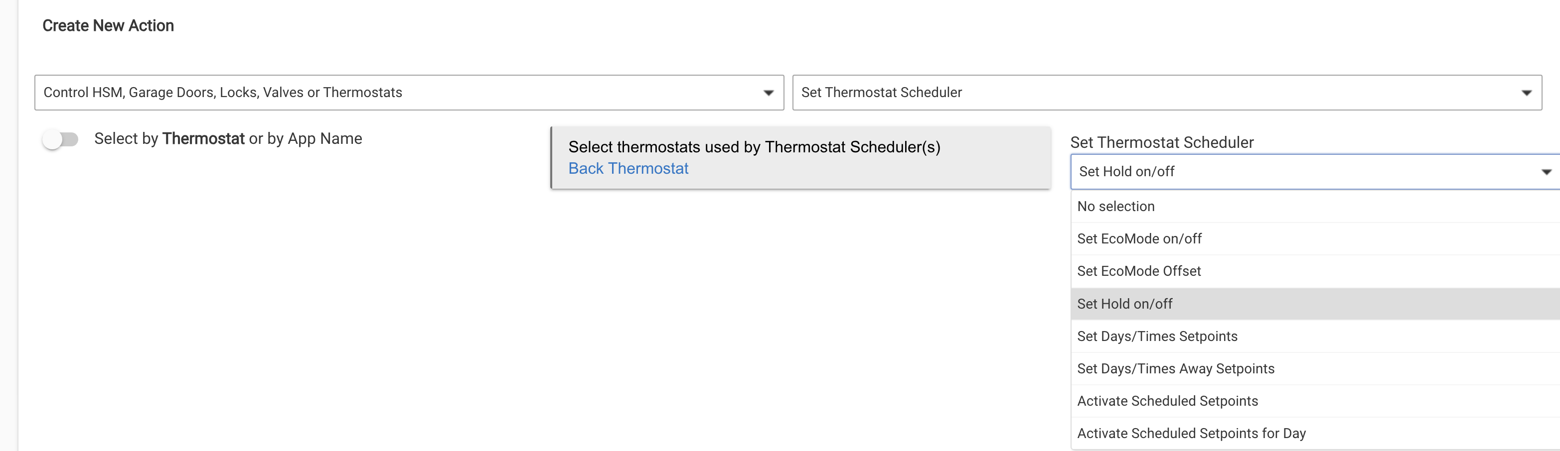

In Rule Machine, where is the command for setting Schedule/Hold? I know it's somewhere, but am missing something painfully obvious and pulling my hair out as a result.
It's here:
It never was a Custom Action -- those are for devices, and Thermostat Scheduler is an app.
Adding to the above, if you're unsure where to find a particular action in the Rule 5.1 dropdowns, check the end of the docs for a list of what is where:
