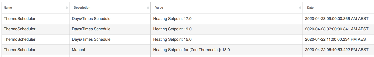

I updated to 2.2.0.121 yesterday. This morning (Thursday) the Thermostat scheduler applied the Leave heating set point at 9am, but it used the value from Saturday/Sunday rather than today.

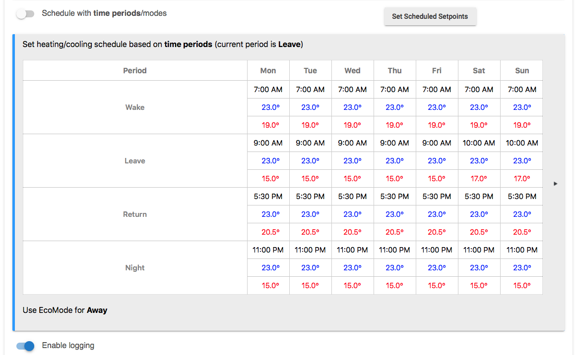

On Mon-Fri the leave time is 9am and the temp is supposed to be 15c. On Sat and Sun the Leave 9am temp is 17.

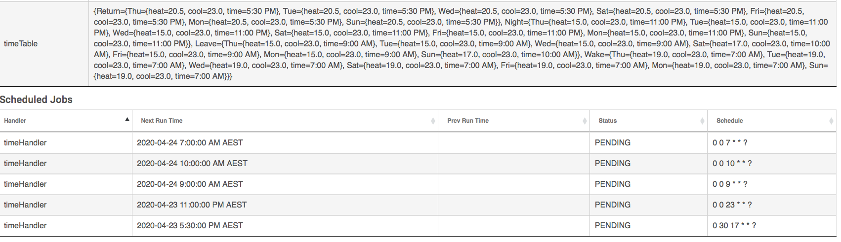

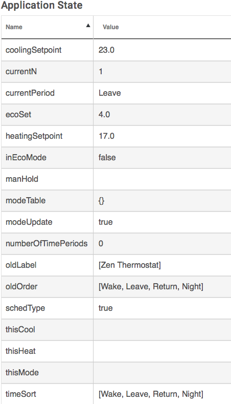

Logs and settings below:
It did it again today (Friday) - at 9am it set the heat to 17 rather than 15.
I deleted the scheduler instance yesterday after it failed again and rebuilt it. Today - Sunday - it got it wrong yet again!
It got the right day because the Leave triggered at 10am, but it used the Mon-Fri value of 15 rather than the weekend Leave value of 17.
