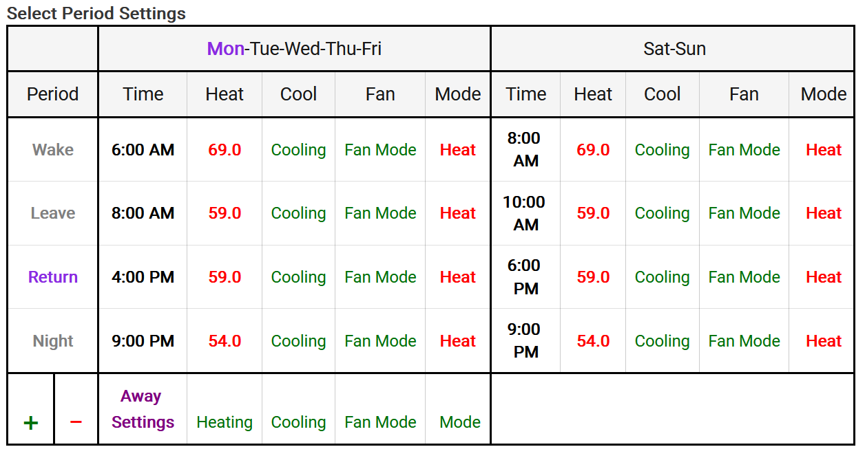

I have a Sinope TH1400ZB thermostat that was working well with the old scheduler. Thinking newer is better I moved to Thermostat Scheduler 2.0, but now it doesn't ever set the temperature. My hub is on the latest release, 2.3.4.132. I have tried removing and re-adding the device and the app, and have done a factory reset on the thermostat and re-paired.

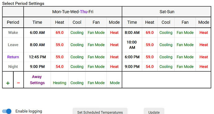

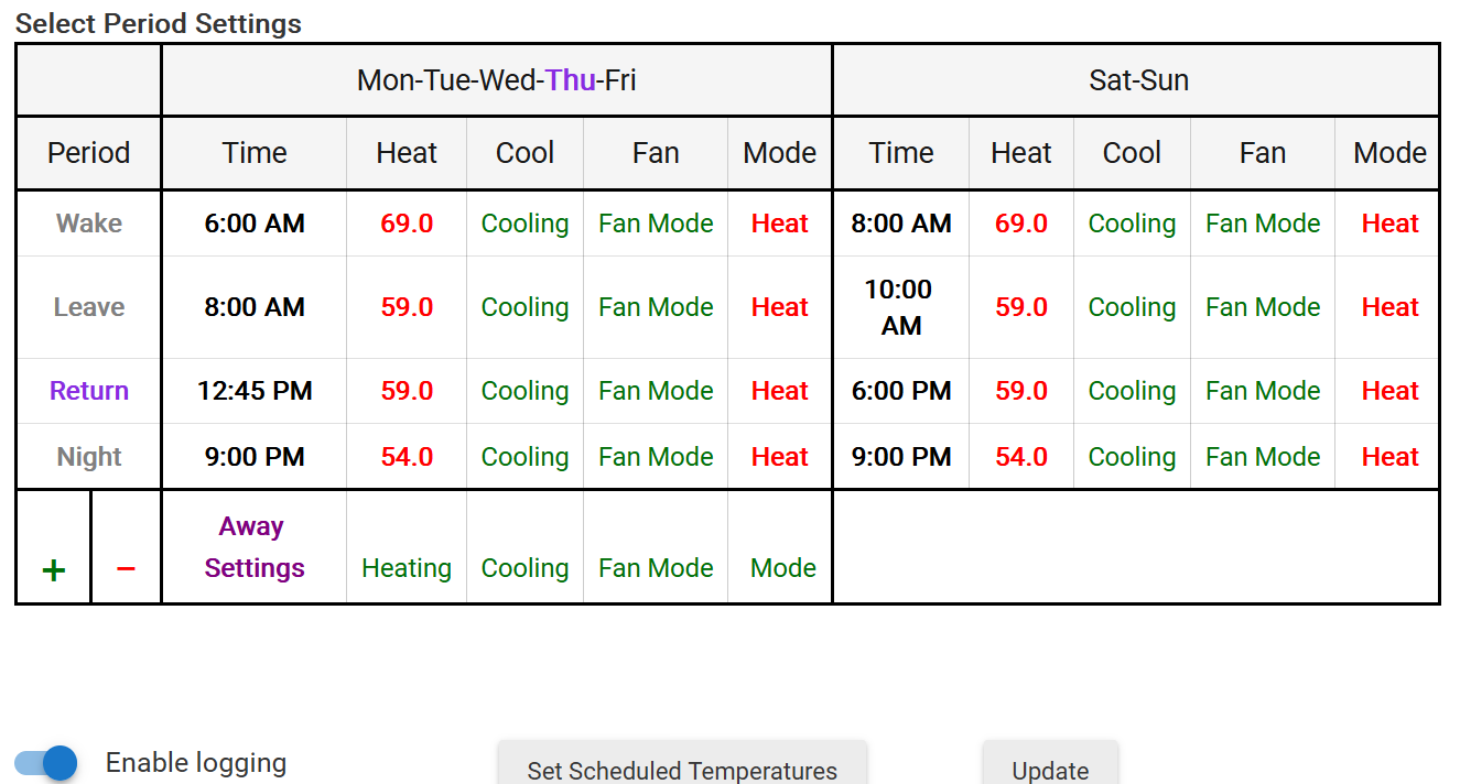

Here are my settings:
Here are some logs from today, after redoing everything. I would have expected it to change the temp to 59F at 4PM, but it's still at 60.
Thanks for any help you may be able to provide.
