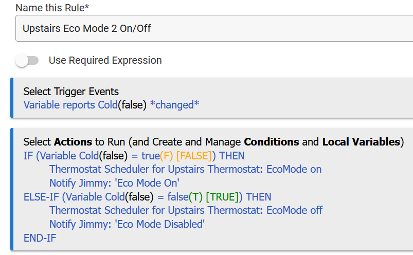

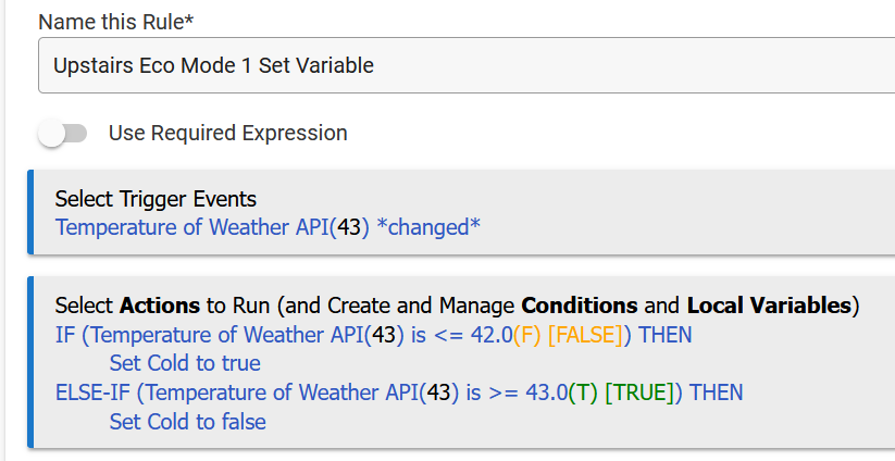

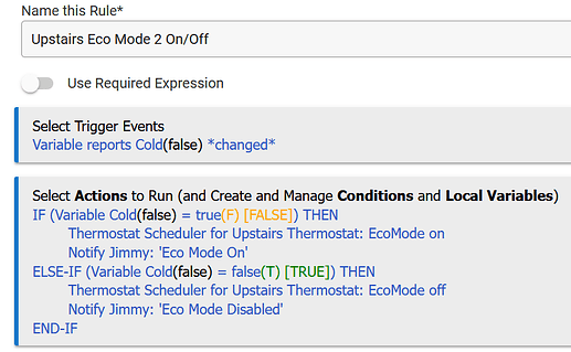

I"m using ECOmode for one of my Thermostats as well but rather than by Hub Mode I have it set a variable. I created 2 rules in RM, the first one sets a variable based on a Weather API temp reading, the second rule monitors the variable the sets Ecomode on or off depending on the True or False of the variable.

Here are the screenshots of how it's setup, if you or anyone else in interested...
Rule 1 - Set the Variable
Rule2 - Change the Mode
