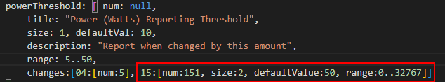

That would be this complicated settings map I invented where I can make adjustments per model number in a universial driver:

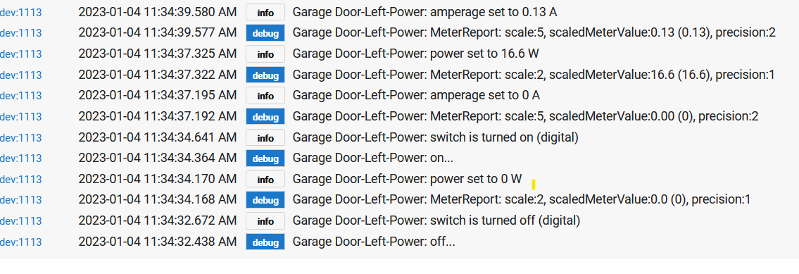

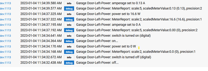

@jtp10181 : On the Zen15, the switch state doesn't change unless refreshed. The switch does physically change. I checked to make sure parameter 24 was 1, and it was. I tried this on two of my Zen15's, and they both did this.
This is the debug log:
There doesn't seem to be a problem with the Zen04. I get a debug message like this when I turn it off and on:
