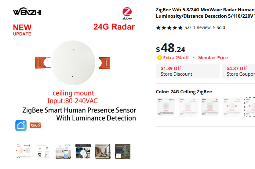

A couple days back I ordered both wall and round versions of the 24G models. The third form factor that I want is the in ceiling mounted version, but it's not in stock.

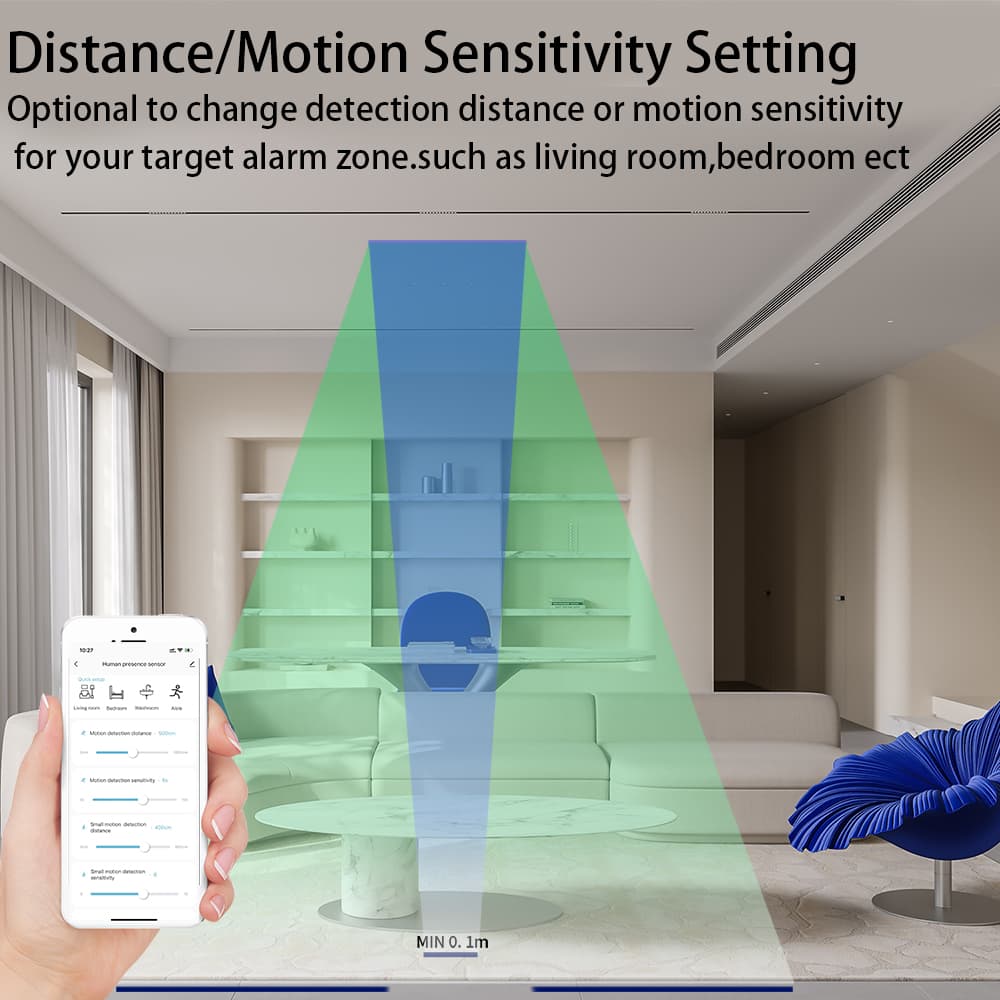

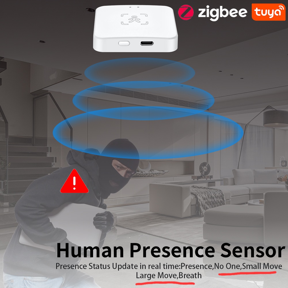

I just purchased the new square shaped 24GHz version... I just had to do it when I saw the connection is USB-C!
Also, judging by the pictures, it seems to be using same settings as your rounded version!

Yep, this is the new better firmware!
The description mentions 'small move', 'large move', 'breath' - these are the NEW presence states that are not available on the old models.
I can also hardly read the last setting as 'Small motion detection sensitivity', so yes - this is the same TS0225 manufacturer _TZE200_hl0ss9oa, but in a square form suitable for wall-mounting.

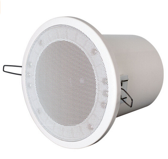

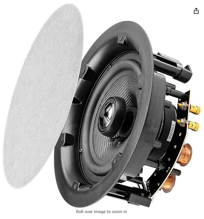

I've been thinking about hiding the looks of these things and it dawned on me that in wall and in ceiling speaker housings with the right grills would be perfect. Throw some usb poe splitters on there and call it a day.
Find some cheap speakers with magnetic grills and remove the speaker.
