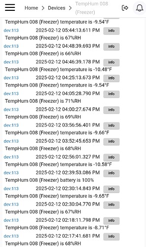

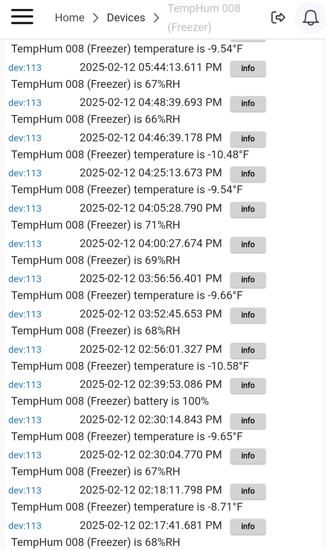

Odd... I used to have the old, square SNZB-02 and had no trouble with them getting down to <-10C. I am currently using the updated (and much better, IMO) SNZB-02P, and it is also only spec'd down to -10C. The lowest temp I see recorded in recent events is -10.84Freedom, which converts to ~-24C.
Based on my experience with both units, I wouldn't have any trouble using them in a freezer, though I understand some people will be spooked by the specs. Not sure why they are rated so 'high,' as obviously the temperature sensor will go lower. Perhaps the tolerance gets a little worse at the ends of the range, or the system chip isn't rated that low, or perhaps they're just worried about battery life. Not sure...
