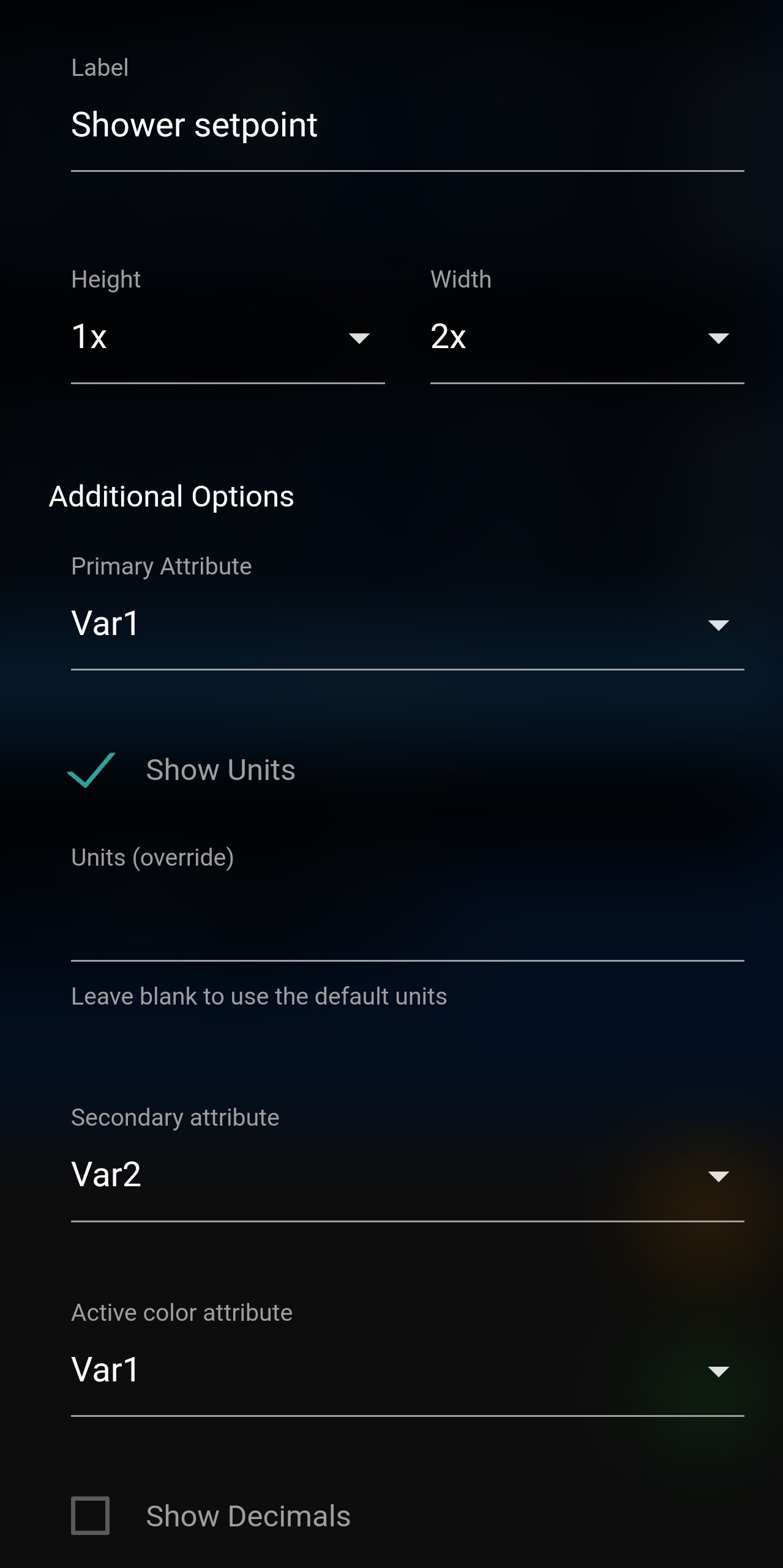

I'm wondering if it might be possible for sharptools to allow multiple attributes?
@josh
There's a request to add a Tertiary attribute to a Hero Attribute tile here that you might want to cast a vote on - or feel free to create your own feature request over in the SharpTools community. :slight_smile:
Perhaps you could share a bit more details on what you are trying to accomplish? It looks like there are two attributes displayed in your example tile screenshots, but it sounds like perhaps you want to break things up even further to display things differently somehow - for example Var1 that has '6*C - IDLE'?

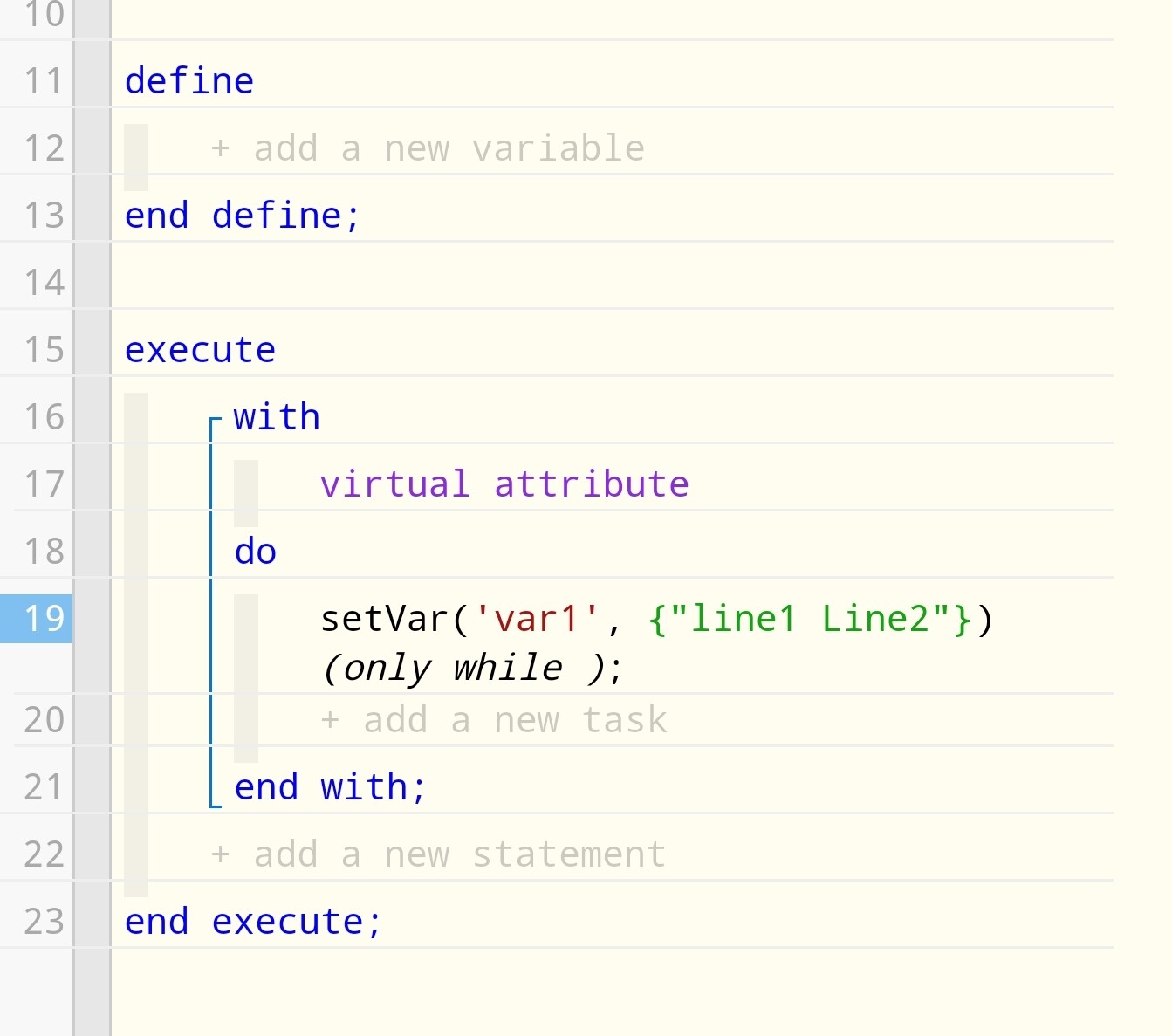

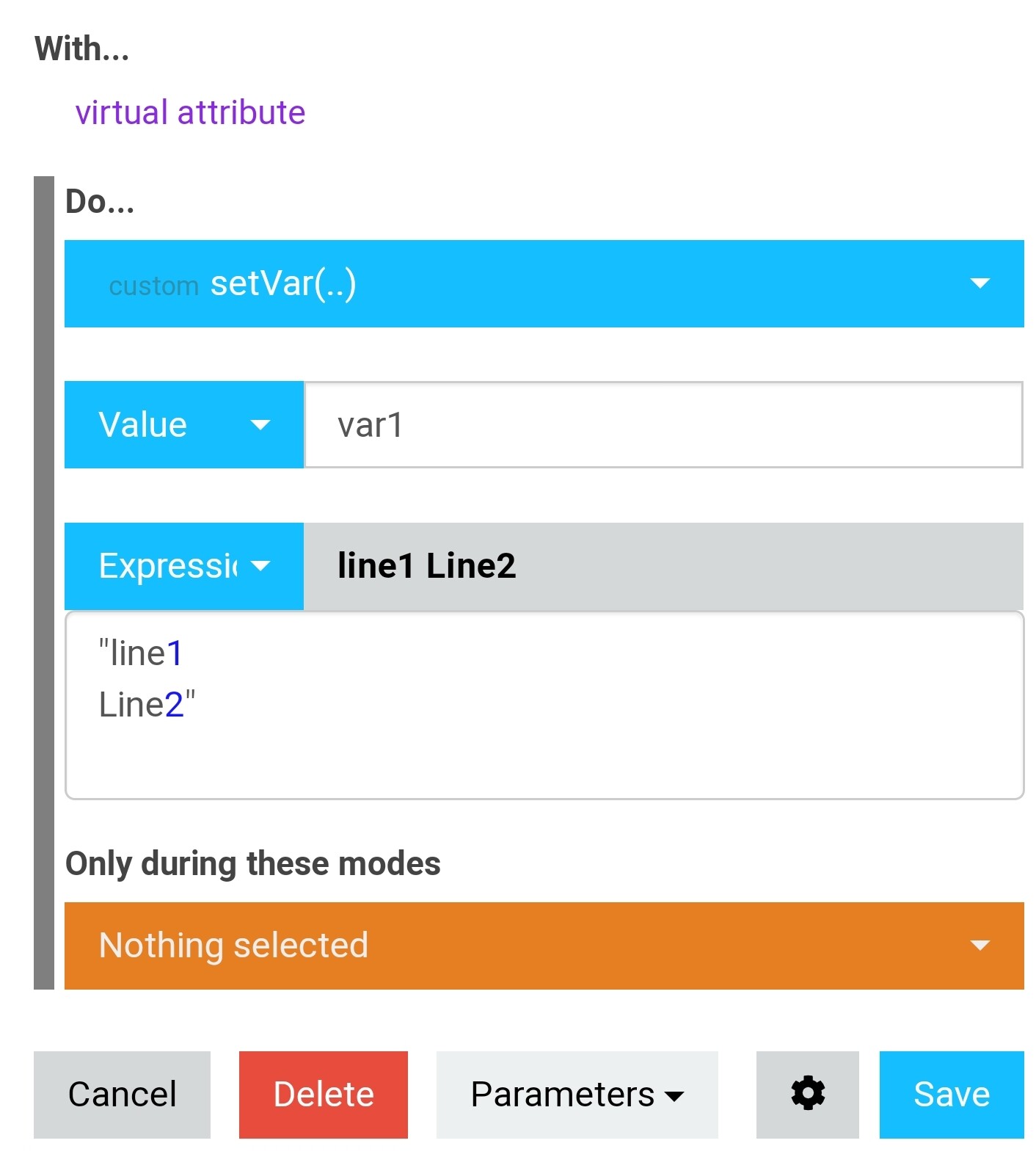

Success!
Turns out webcore works just great by hitting 'return' too.
Cheers all! Simple solutions eh? =)

I use webcore to accomplish the same. I use a < B R > for my CR/LF newlines which don't show in the code.
piston
Im using the setvar to set a tile in dashboard and filling in the info from webcore
