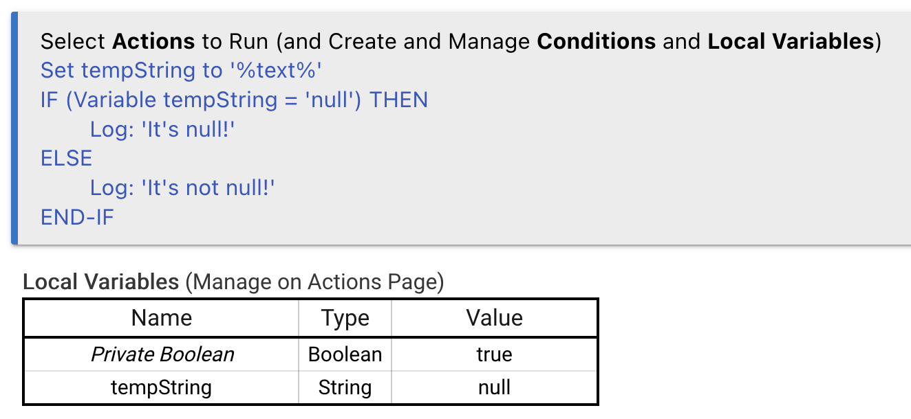

Just checking if it's equal to the literal string "null" works for me. You do have to assign the value of this variable to a "real" variable to be able to use it in the first place, including to check its value, but you can do so after that. Here's an example:

Thanks, I must have mistyped something when I tried testing for n u l l.
Works as you described.
