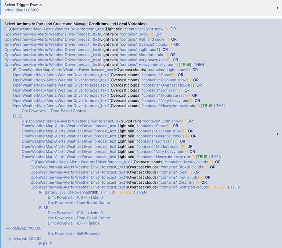

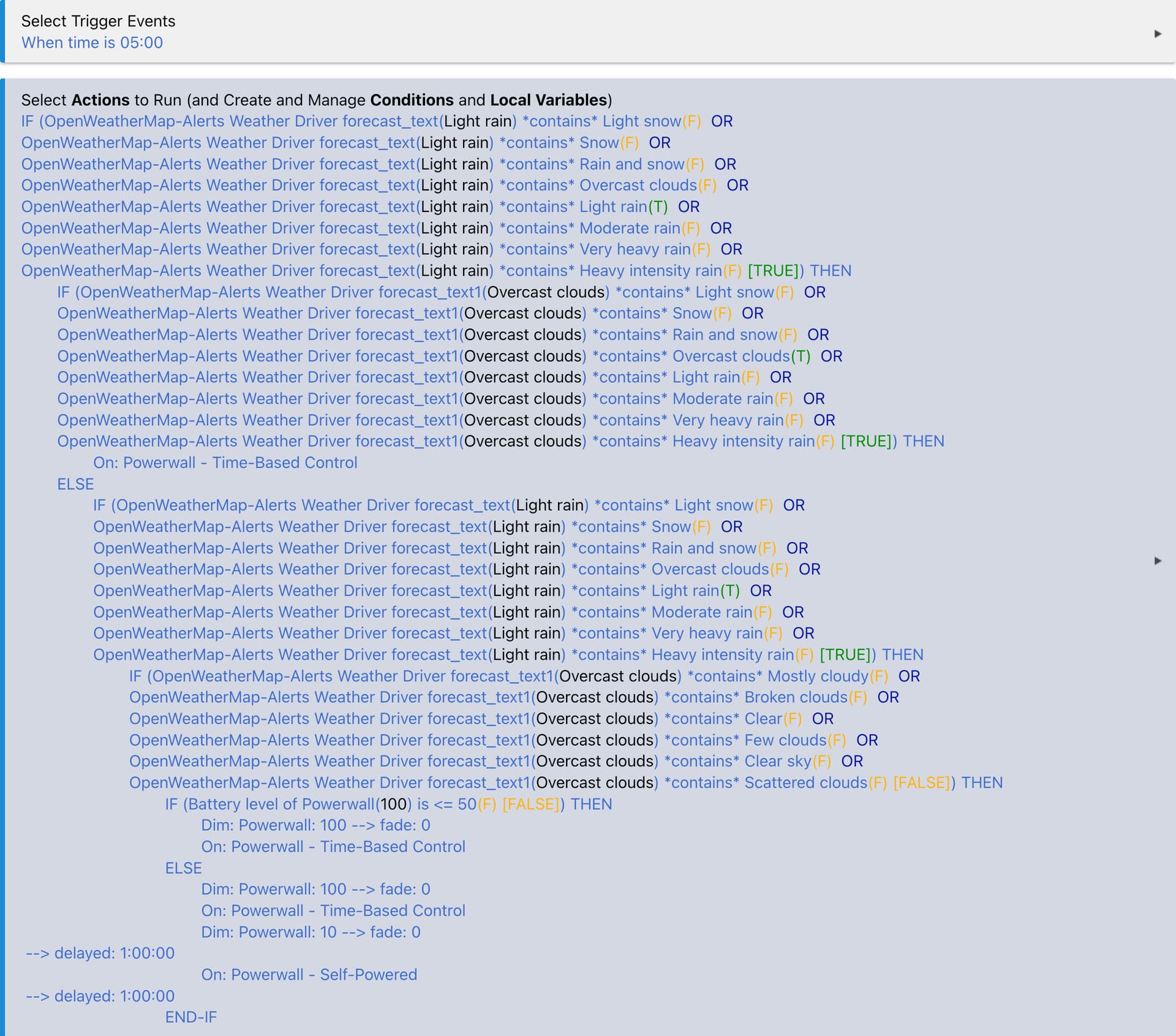

Okay, so I'm doing this same thing. I set an 0500 hrs rule that asks if the weather forecast for the current day will be inclement or nice. It ignores the Powerwall SoC in the beginning since that wasn't necessary; at the end, I added a Powerwall SoC check:
This seems to do what I want it to do. @ 0700, rates double, so I added a rule in Powerwall Manager to cut off battery charging @ 0655 (the extra 5 min is necessary because I have observed that battery charging will continue for 1 - 3 min after the command is issued).
Yesterday, I noticed that battery charging had not commenced @ 0500; the system did switch from Self-Powered mode to Time-Based-Control, but it was only drawing enough energy to run the house. Upon further exam, I noticed that if I set Backup Reserve to 100%, battery charging would commence. Normally, Backup Reserve is set to 10%. Thus, I added some Actions near the end: "Dim: Powerwall: 100 --> fade: 0", etc. Those were necessary to get battery charging going...wasn't necessary until yesterday. Not a big deal, but it has worked (all of the one time I tested it. I will know tomorrow morning if it does because the forecast is rain. N = One!!).
Happy to entertain criticisms, suggestions for improvement, thoughts, etc! I have some skills, but mostly learn by setting things on fire...
*Edit: a few words of explanation: Powerwalls charge max rate from the grid @ 10.8 kW in Time-Based-Control mode, and 3.9 kW in Self-Powered mode. Most of the time, the system is in Self-Powered mode. Most of the time, the Powerwalls don't need more than 2 hrs to fully charge or reach a reasonable SoC, thus the 0500 time point.
My objective was to make sure there is enough energy in the Powerwalls to get us through at least one 24 - 36 hr period with no grid power and very little solar. This is quite uncommon, of course, as our grid is very stable. However, it is perhaps the worst case scenario. Hope for the best, plan for the worst. I've seen rare mornings where the Powerwalls are run down to 11% just as solar begins to produce enough to charge them, and an even fewer number of times when they run down to 10%, so I've set about tweaking the settings to compensate, thus the Rule above (in its current form...there's always room for improvement). We now have Powershare, which changes everything (and I've created a "BackFeed Solar Project", which takes energy from a few el cheapo solar panels, run through a couple of grid-tie inverters and fed directly to my house. The Powerwall system sees this as a reduction of house load. This also changes everything!).
