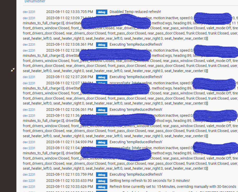

  • v 3.52 add temp refresh times of 30-Seconds, 20-Seconds, 10-Seconds (must be exactly input like this)
    this will add a wake call and then temporarily add an extra refresh every xx seconds for 3 minutes then shut off.
    Does not change normally schedule refresh (that is left in place). This is just extra calls.
tested this with 20 and 30 secs.. if car is not awake doesnt really do anything so added a wake up call first.. In test below with longest time (30 secs) car does appear to stay awake.

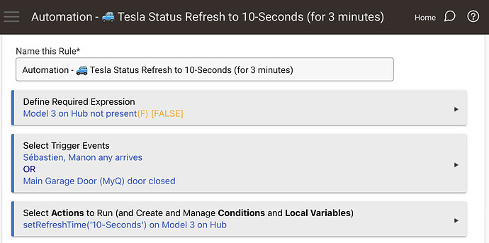

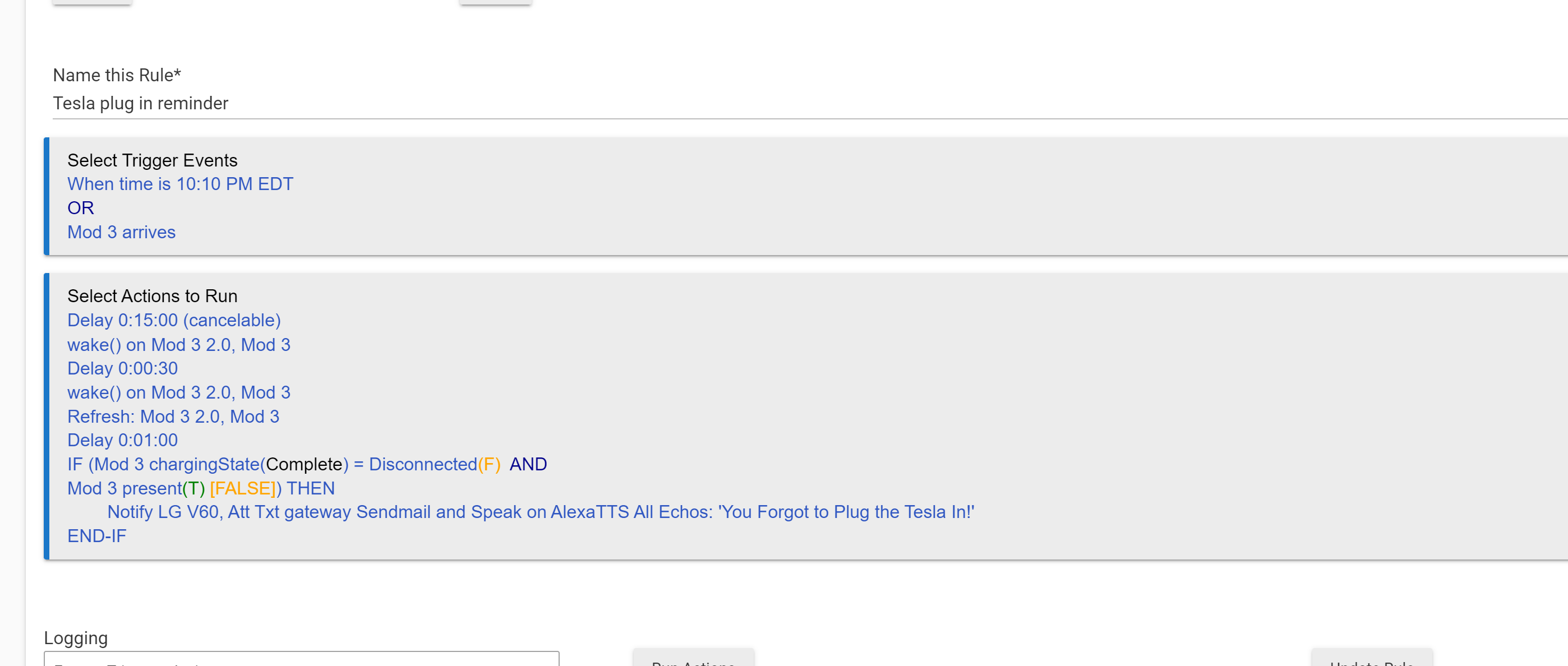

This allowed me to make the refresh rule much simpler! :blush:

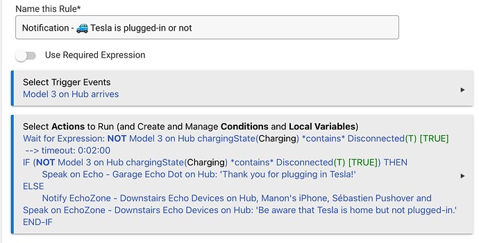

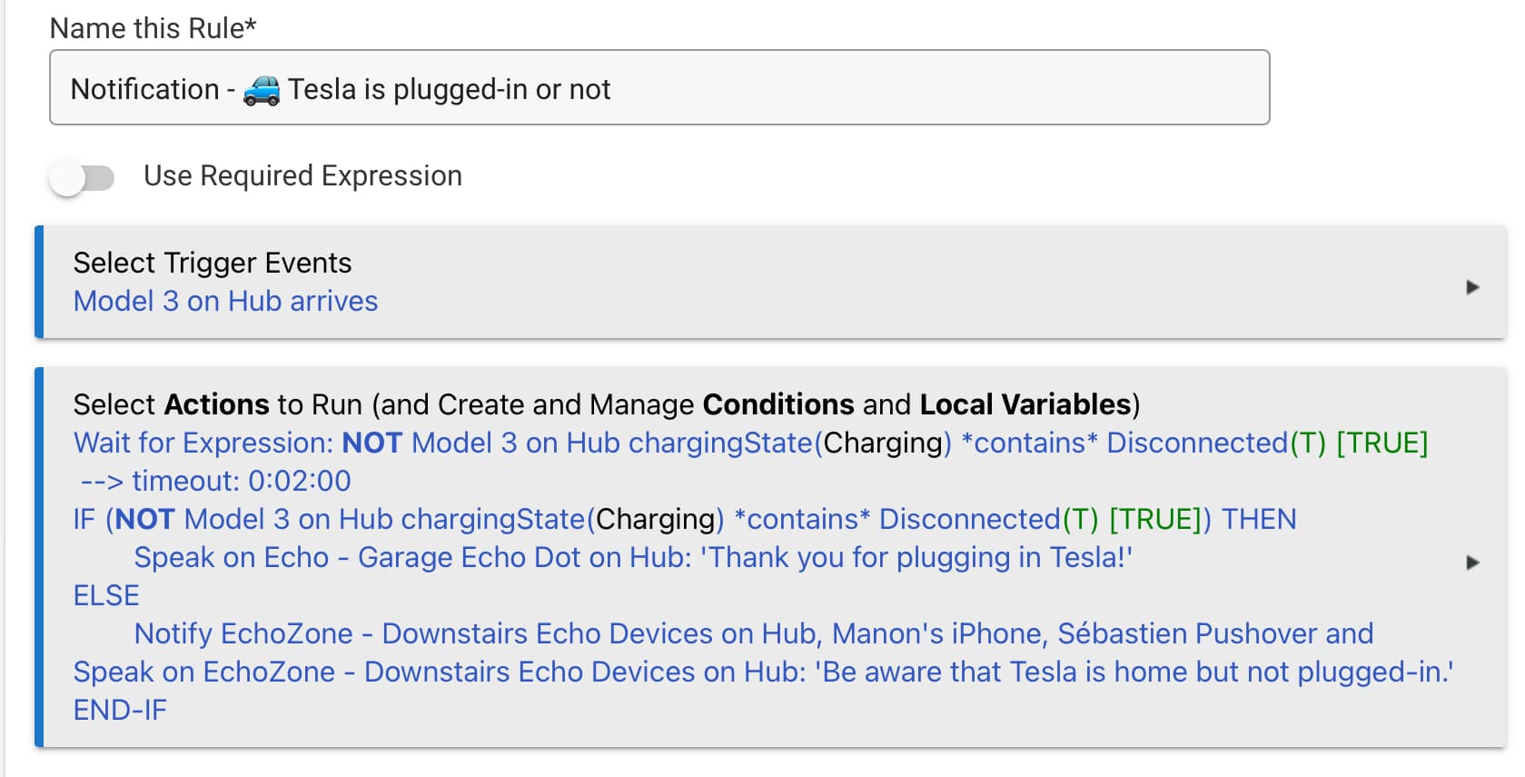

I have a separate rule that will run once the presence is confirmed:
2 issues what happens if car is flagged as arrive before the person or door is closed..

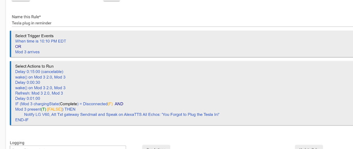

2nd my arrival rule does the same thing but includes wake ups..
It won’t run if the car is flagged as arrived before the person or door. I will be looking to see if that occurs often or at all… but didn’t want it to be triggered every time we closed the door or we arrived, and thought that might do it. The experiment begins! I used the vehicle once since and it worked! Though the rule gets triggered by both the door and the arrival, so I will need to add another restriction (boolean variable).
I would assume that the car is awake since it is being driven, but maybe the connection to the server needs to be awaken?
No it should be awake but i added an awake anyway when u set the reduced time as it cannot hurt and if you do it while vehicle is asleep it does nothing except consume resources on.the hub.

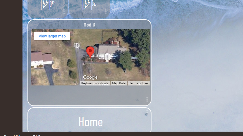

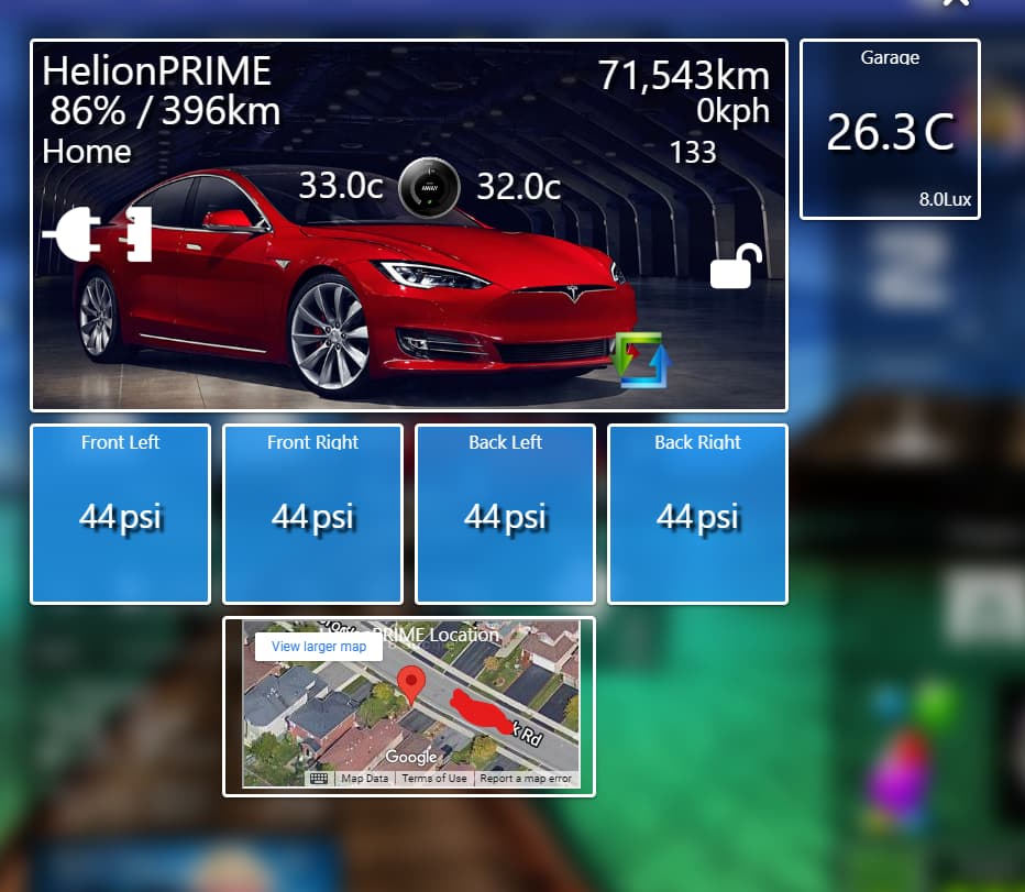

Is there a way to use the zzziFrame attribue in a SharpTools dashboard to embed as an iFrame for display in a tile? Also... WebCoRE dosen't seem to see this attribute.
you will have to ask them.. it is declared and does show as an attribute in a normal dashboard... see below... As for webcore same issue ask them , maybe it doesnt support an attribute type of text. as i said it is visible in rule machine and regular dashboard. Does webcore support any custom attributes? Maybe there is a special way to do it.. Again, I don;t use it so you will have to post in that thread asking them.

You could use the Hubitat HTML Attribute Display custom tile in SharpTools for this:
Thanks Josh. I'll take a look and see if the attribute shows up in SharpTools. In the end if it doesn't work it's not really important, it's just nice to have on the dashboard from a fun point of view.
Worked out great!
