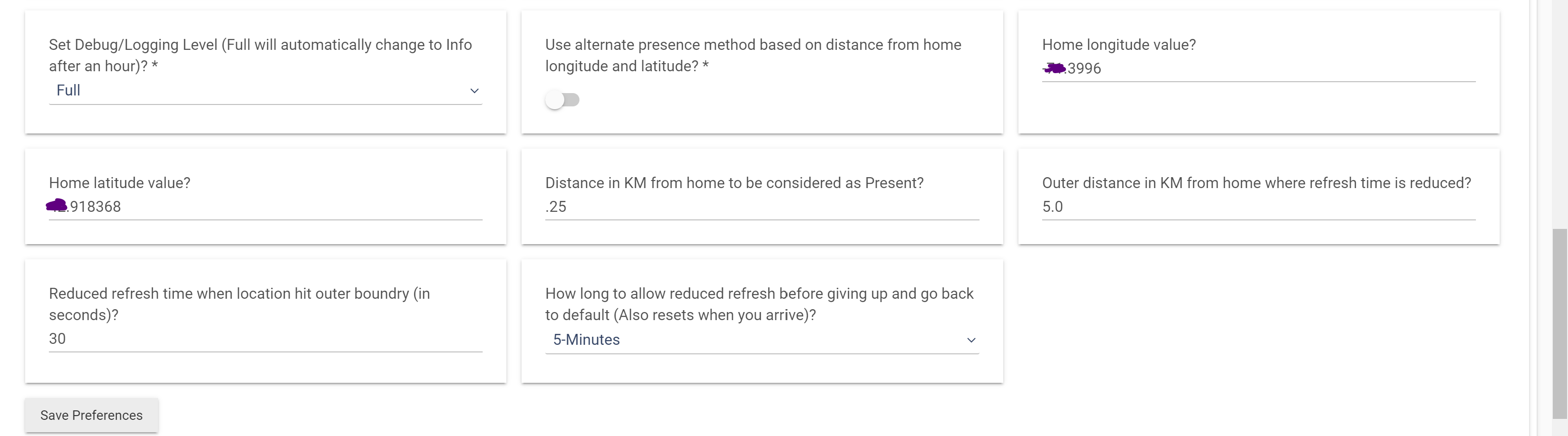

  1. outter (higher) boundry range (only when no present and moving) where refresh time is reduced.
  2. what the reduced refresh time should be in seconds..
  3. how long to leave the smaller refresh time without arrival before disabling it till next arrival and going back to original refresh time.

Just tried the new settings and they are working great! Had to set the radius to .5 kM for it to work, but likely because I’m not yet using the right center point for my location.

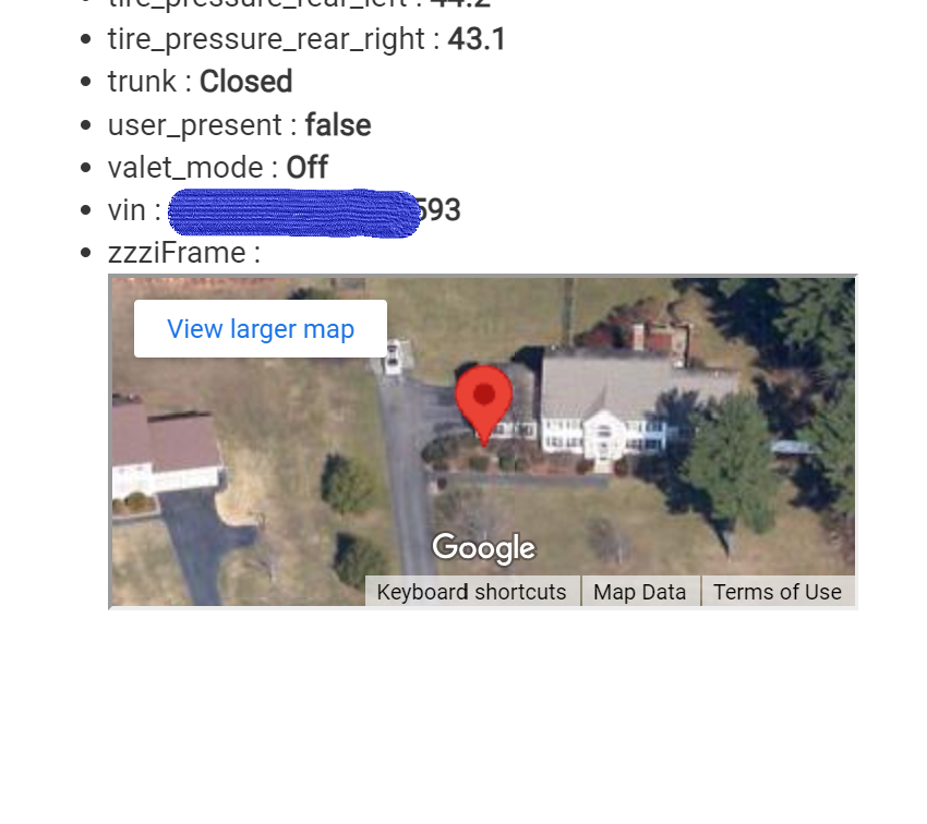

you can get the right center pt. by looking at the long and latitude in the device panel attributes when your car is in the garage/at home.
it also may not work depeding on your refresh timing.. that is why i am adding an outer diameter ring where when entered reduces the refresh time for x minutes.
i have just completed that and have asked brad to test it.. if you also want to test it .. send me a private pm.. i dont want to post till the sucess case is tested. I did test the timeout case where the reduced time is cancelled if you dont get home in x minutes after entering the outer ring.
i cannot test the other case as i am not at the location where my car is.
here is what the new parameters look like:

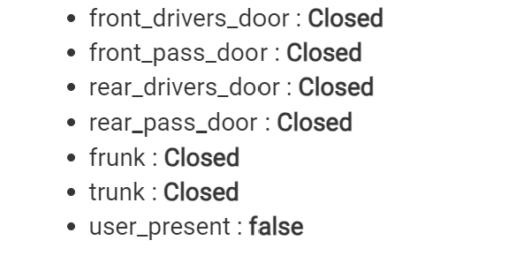

also added these new attributes as requested previously.. not released yet till testing is done on the new boundry changes.
Screenshot 2023-08-07 125625
Oh nice!

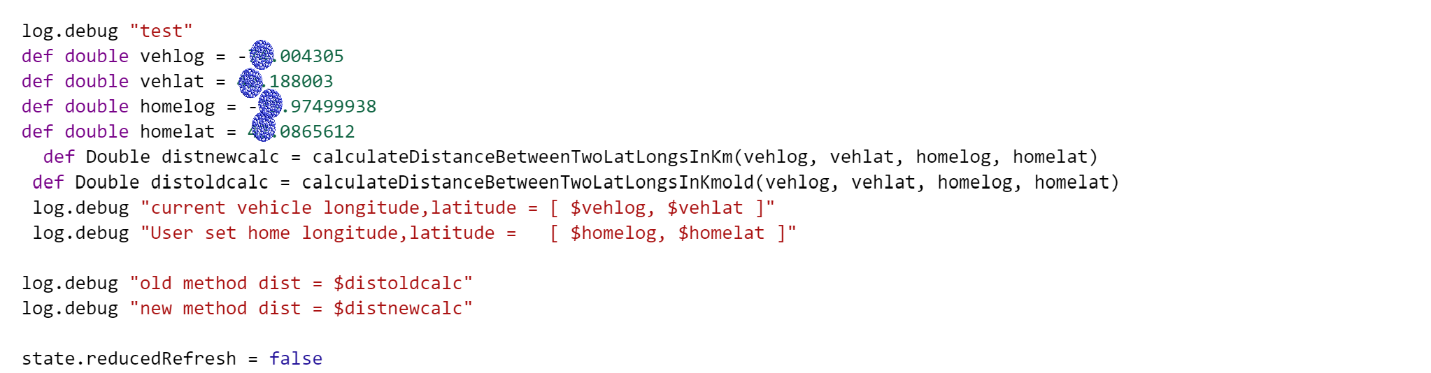

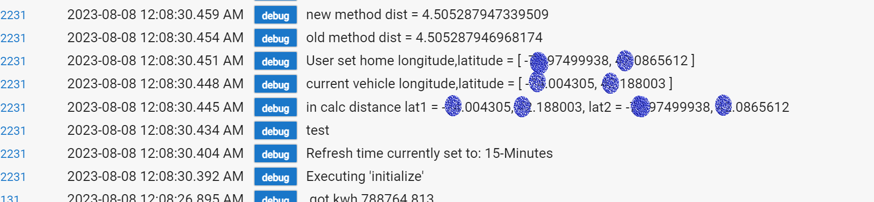

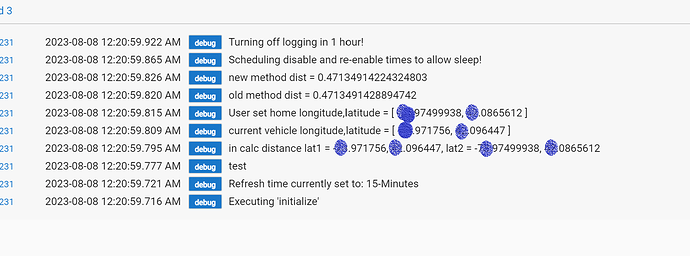

brad did some testing and the distiance between the two points was incorrec vs google so he posted a different fx to calculate it than i was usiing.. but when i ran tests with each fx they came out the same to within like 10 decimal pts.
only thing i can summize is that there is some problem in the math calcs on the hub or something.
either way you can adjust your distances accordingly so i am going to release it for others to test

I used Google measuring tool, and distance was as the crow flies, so not sure why the discrepancy between the 2. Maybe because of the elevation. But since both calc tools are giving the same results, seems reasonable to go with that… and exact distance prob doesn’t matter all that much anyway, since each user will need to play with distance, refresh rates, etc. anyway to get a combination that works for you.
Interested to see how this works for others! I likely wont be driving again until Thu, so I’ll test this release then.
Thanks for testing. Really Weird that the numbers don't match google. the only other thing i can think of is a bug in the math fxs or a rounding error the same in both fxs.
Since they produce the same results at least in groovy i went with the original that has less math fx calls as it will be leas draw on the hub.
I may code up my test in c++ and ses if i get the same results.
