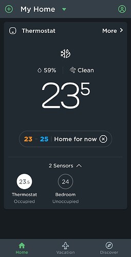

I was wondering why the current temperature on my Ecobee unit is reporting 23.5C but on the Hubitat device, it is reporting as 24C. Any idea why there's a discrepancy? TIA.
Just a guess, but if you round up from 23.5, you get 24.

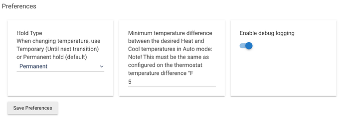

I'm using Sharptools for my dashboard so I don't have that option. BTW, what about this Minimum temperature difference... preference? What exactly does this do? Will changing this fixes it?
I think that is to ensure adequate separation of the cool and heat setpoints in auto mode. This will prevent endless cycling between cooling and heating.

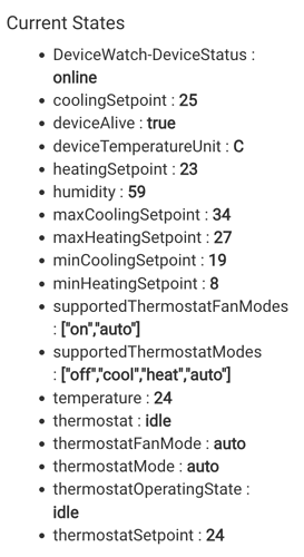

From the screenshot of the device Current States, the issue appears to be the temperature recorded on the device, not an issue with the display of that in a dashboard, unfortunately.

The OP’s issue is unrelated to dashboards. As Simon said, the screenshots are of the device settings page.

I have a feeling that the Ecobee built-in driver doesn't support a 10th of a degree in Celsius as even the Current States doesn't indicate it. Perhaps I'll give the Ecobee Suite by SANdood a try and see. Thanks all.
