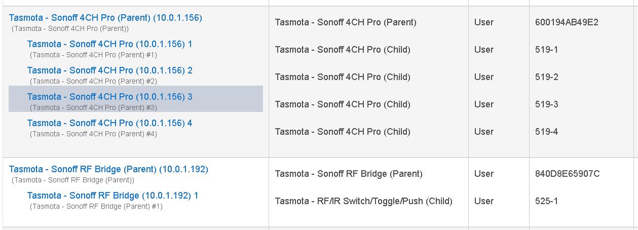

Next I used the Tasmota Connect App in HE to add them both as Parent Devices, pls see attached screenshot.

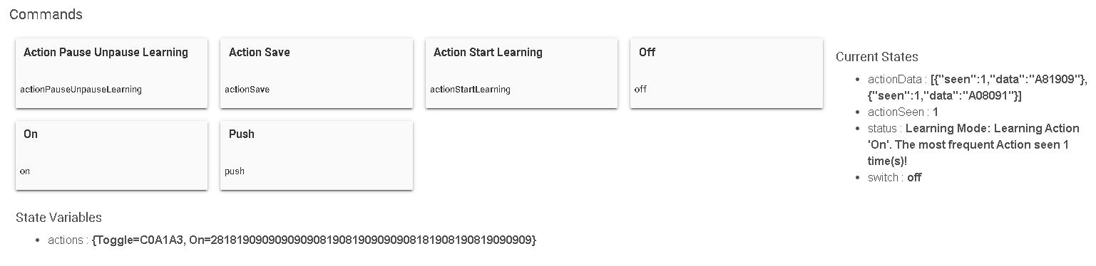

It says to press the RF Buttons multiple times, seperately, in order to capture the info required but also to obtain the RF Codes for each individual button and after I do this, capture the data, save it and finally refresh the device page to see the State Variables, it only shows one state, not 8 states as in one state for each button.
I though being an RF Bridge, it would show seperate State Variables to use with say RM but that's probably my fault for assuming this :crazy_face:

Forget about B0 and B1, that is for sending RF commands FROM the RF Bridge, that is not fully implemented in the released version.
In your scenario you need to set "Number of Children" to 8 in the Parent driver, then do as you did for the first button for each child (learn the Toggle command in each child device), that way you'll end up with one toggle switch for each button.
