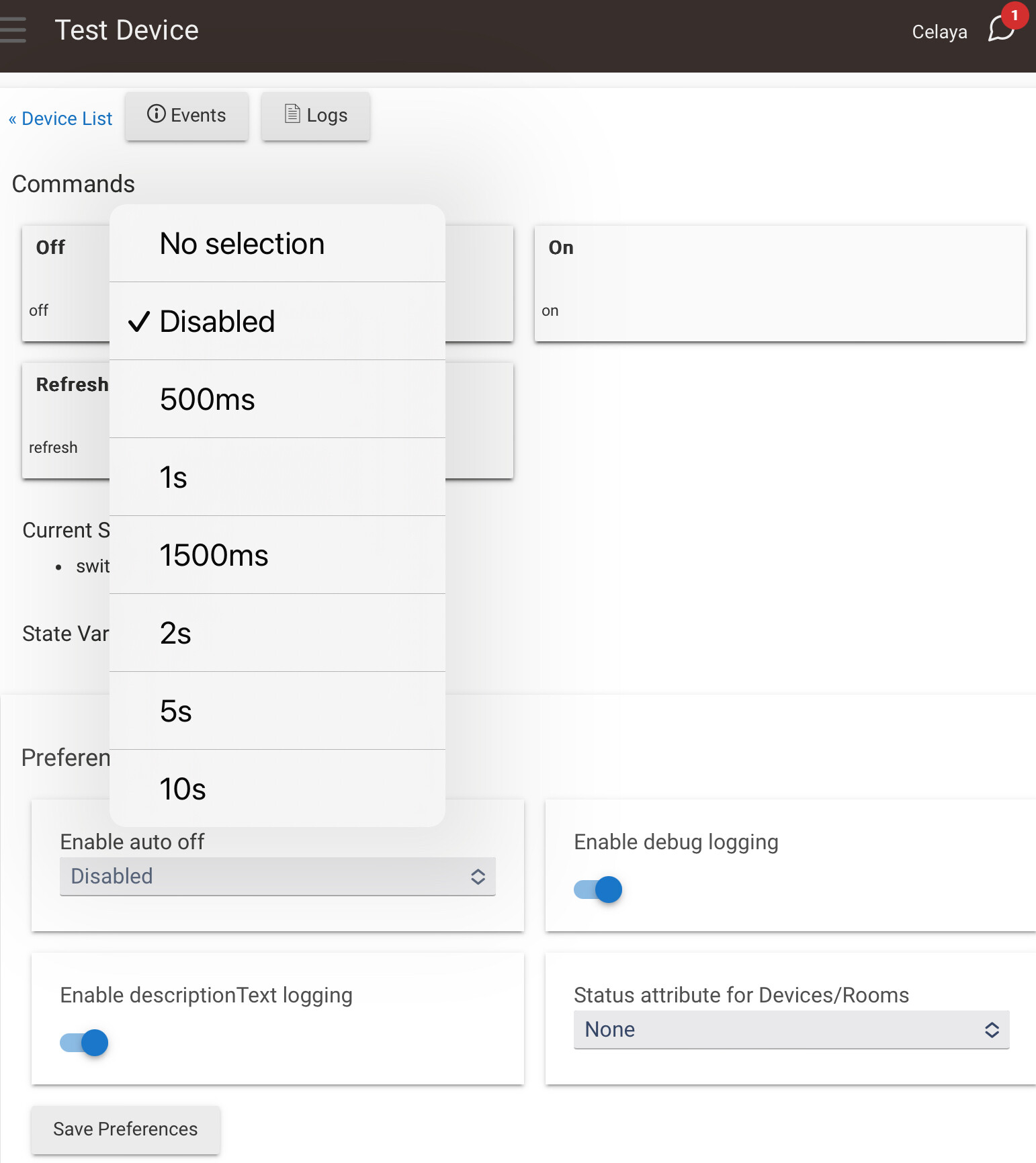

@garyjmilne is there a way to configure a switch to act as a button, or with an option like to Enable auto off option?
I modified a Sonoff switch to act as a dry switch to use it at a garage door connected to the door motor, but it just turns on or off.
The option I am looking for is like the one that is included on a Virtual switch like this, with the Auto off option
I guess I can set a RM rule that takes care of the switch turning on, and after a second change to off, but just want to make sure there is no easier way to do it.
Thank you for your help.
