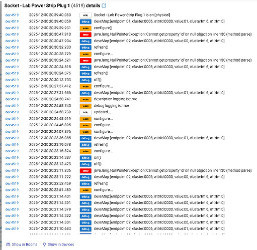

These logs are from the "Tapo Smart Matter Outdoor Dual Plug" driver, I suppose...

i deleted the child device, changed the device driver to "generic matter multi-Endpoint switch and clicked configure and these are in the log

The four switches should be working now, I don't see errors in the logs.
