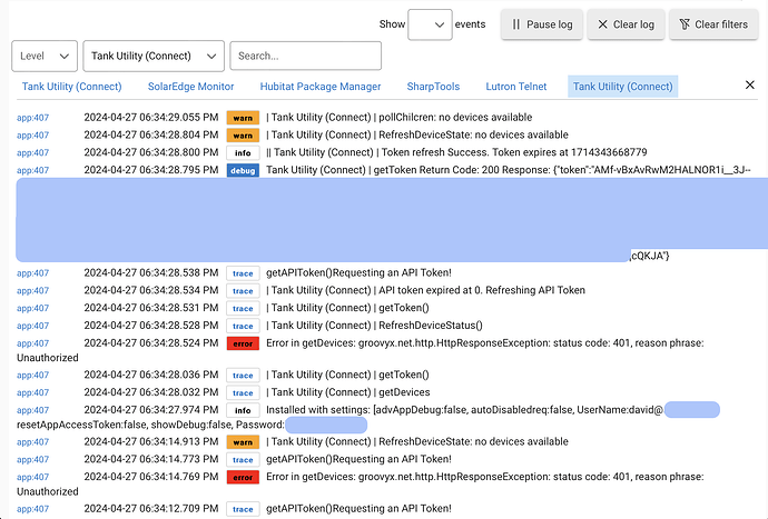

@mluck & @nh.schottfam, thank you again for your help. I am still having the problem of no trace of the device once the TankUtility package is installed and set up. I started all over again, uninstalling from HPM, rebooting hub, confirming that all traces of the app and driver were gone, reinstalling via HPM, setting up with username and password, confirming successful authentication, etc. There is no sign of a device related to TankUtility. This is why the last time I attempted to install the new device. Can you comment on where I might be making the error? Note that this is a 2nd gen TankUtility device (not the newest) and that it is fully accessible via the iOS and web interface. Thank you.
Logs:
app:4052024-04-25 01:02:59.876 PMwarn| Tank Utility (Connect) | pollChilcren: no devices available
app:4052024-04-25 01:02:59.606 PMwarn| Tank Utility (Connect) | RefreshDeviceState: no devices available
app:4052024-04-25 01:02:59.597 PMinfo|| Tank Utility (Connect) | Token refresh Success. Token expires at 1714150979589
app:4052024-04-25 01:02:59.483 PMdebugTank Utility (Connect) | getToken Return Code: 200 Response: {"token":"AMf-vBy54GiF4 ...
app:4052024-04-25 01:02:59.348 PMtracegetAPIToken()Requesting an API Token!
app:4052024-04-25 01:02:59.346 PMtrace| Tank Utility (Connect) | API token expired at 0. Refreshing API Token
app:4052024-04-25 01:02:59.344 PMtrace| Tank Utility (Connect) | getToken()
app:4052024-04-25 01:02:59.340 PMtrace| Tank Utility (Connect) | RefreshDeviceStatus()
app:4052024-04-25 01:02:59.337 PMerrorError in getDevices: groovyx.net.http.HttpResponseException: status code: 401, reason phrase: Unauthorized
app:4052024-04-25 01:02:58.877 PMtrace| Tank Utility (Connect) | getToken()
app:4052024-04-25 01:02:58.875 PMtrace| Tank Utility (Connect) | getDevices
app:4052024-04-25 01:02:58.816 PMinfoInstalled with settings: [advAppDebug:false, autoDisabledreq:false, UserName:david@skymax.ca, resetAppAccessToken:false, showDebug:false, Password:bFVCDxBbdp4e]
app:4052024-04-25 01:02:53.318 PMwarn| Tank Utility (Connect) | RefreshDeviceState: no devices available
app:4052024-04-25 01:02:53.178 PMtracegetAPIToken()Requesting an API Token!
app:4052024-04-25 01:02:53.175 PMerrorError in getDevices: groovyx.net.http.HttpResponseException: status code: 401, reason phrase: Unauthorized
app:4052024-04-25 01:02:52.323 PMtracegetAPIToken()Requesting an API Token!

Thank you for your comment. I figured that was the case, but I don't know the cause of this error. When I run the Connect, it asks for my credentials and returns the result, "Authentication Succeeded". Is it that the token needs to be updated? I previously ran a curl command from terminal to get a API token. That worked properly, but I later decided that using @nh.schottfam's code I didn't need to insert my token manually. Do you have any ideas as to what I might be doing wrong?

The error you're getting is at about line 254, which should mean that the initial request for the token was successful, but when the app attempts to use the token it's receiving the 401.

It would be good to see all the logs for when you try to connect.

@nh.schottfam, I'm back, and I did everything you suggested, as far as I know, except, I used Hubitat Package Manager instead of installing user app. Is that OK? I had installed user app before a couple of times, and couldn't get it to work (same symptoms as now, installed fine, no ability to communicate), so I moved to HPM. Here is the log file from my reinstalling. You did say that I didn't need to uninstall the code, but I tried without doing that, and it didn't work. Here is the log of the reinstall. Note that the second Tank Utility (Connect) is no longer installed, just log items from earlier:
Yes, I am using the same login that I use with the app, and that login returns "Authentication Succeeded".
Does any of this explain my issue? Same inability to get passed 401, reason phrase Unauthorized, and to see a new device. Note that the installation succeeded and so did the initial authorization, as shown in the package install.
