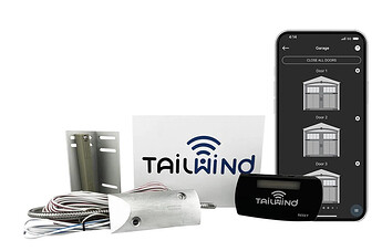

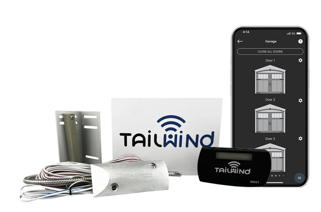

Here's some info on their controller for those interested (don't have one myself).
Tailwind iQ3 Smart Automatic Garage Controller Pro with Universal Sensor
