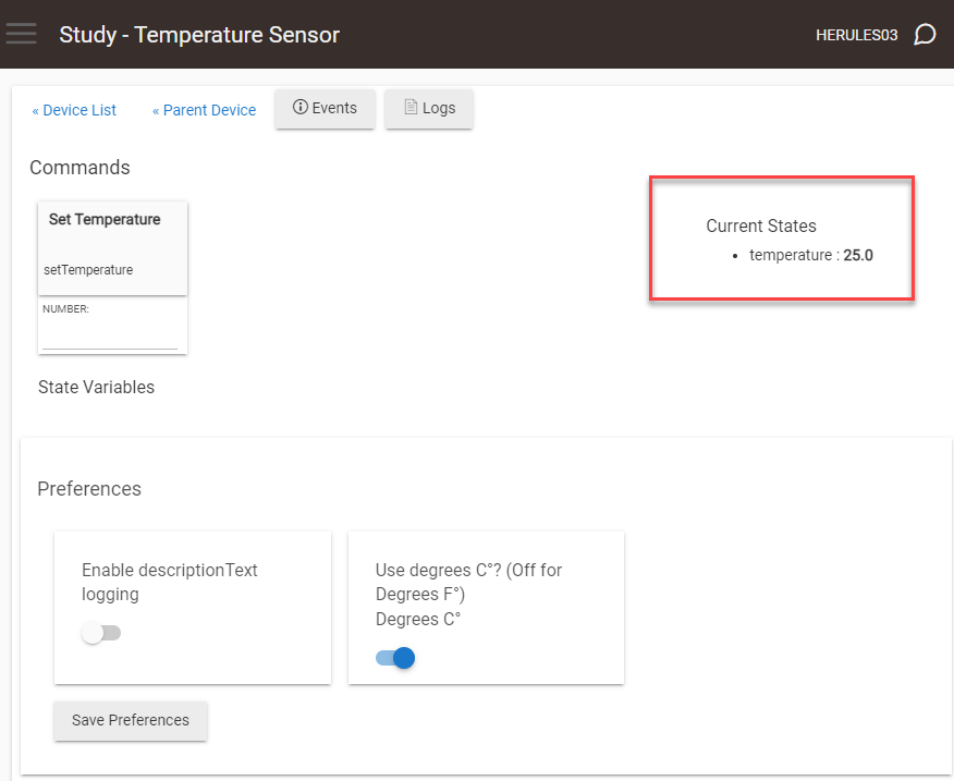

In general the HE built-in Dashboard obtains it's data for a tile from the Attributes of the device, displayed under the Current States heading in the top-right of a Device page.
I have never seen or heard of the kind of feature / steps Chat GPT was referring to. I wonder if it was quoting details about another dashboarding platform, and not the HE offering?
Also, the log you showed in your post was actually generated by the app, not strictly the device driver (see the "app" reference at the beginning of each log entry). That said, the fact that the app is receiving and interpreting the outside temperature if a promising sign. If the outside temperature is not currently available in the device attributes, it may worth requesting this be made available in some way, most likely on a separate device I would expect. Is the App / driver the custom Tado Connect one, or something else?

With your first question I was suggesting you contact the app developer and request the outside temperature be made available to include on a dashboard. The reason I was saying a separate device may be best is so you could use it more easily where a temperature sensor can be referenced, such as when using the Temperature tile Template or in rule in HE. If you are familiar with programming you can always modify the app code yourself to add features such as this, but ultimately it would be better to have it available in the main version of the app.
