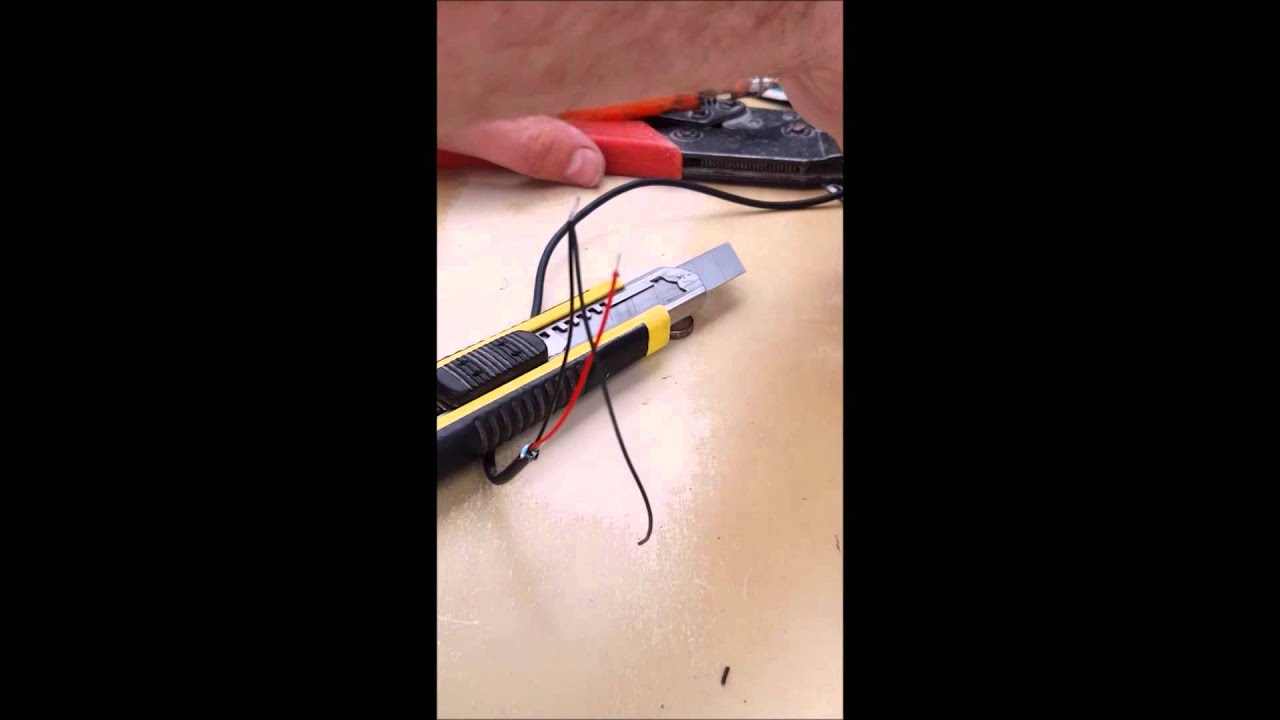

@scubamikejax904 Sounds like the battery is going dead. Before it starts expanding, I would hardwire the power supply. Simply remove the chip from the battery and solder the power leads to the board and be done with it.
Thanks @rlithgow1 that was my thought too. I put it on a way old apple charger (1a, that I keep around because...well because) and it charges up super quick even with the screen on full power and never sleeping. I am going to do a test tonight and see how long it stays on without power, but am leaning towards bypassing the battery. Not sure how difficult that actually is, I know it's beyond my skills. (If I can find a guide online I could probably get it done by someone local) any suggestions on some sort of guide?
Probably not necessary. Given that using a regular charger works, then the battery isn't shot, probably just an issue with the transformers you've been trying.
If you are still set on it, here's an older vid to give you an idea.
