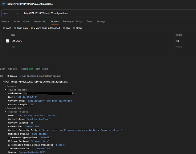

I've got a PUT method that works using Postman, but I cannot get the syntax correct in asynchttpPut for it to work.
What I've got in Postman is:
As you can see from the screenshot, the request is using content-type "application/x-www-form-urlencoded" but the response is using "application/json". So I've tried using the parameter "requestContentType" in the asyncHttpPut call, but it results in a 403 - Forbidden error. I've also tried "contentType" with the same outcome. My asyncHttpPut call is using the following parameter map:

What I have realised now is that my request from HE is also missing the "Content-Length" parameter (see Postman snapshot in the first post). I have figured out how to calculate the value for the length (trial and error using Postman), but not how to add it to the parameter map in HE. If I add it to the headers:

Which gives me a 200 response, but with an "empty" value of "{}". This is the same response I get using Postman if I remove the "Content-Length" header from Postman. But I don't know if this is the issue with asynchttpput since I cannot determine whether or not it automatically calculates and supplies the Content-Length parameter in the call.

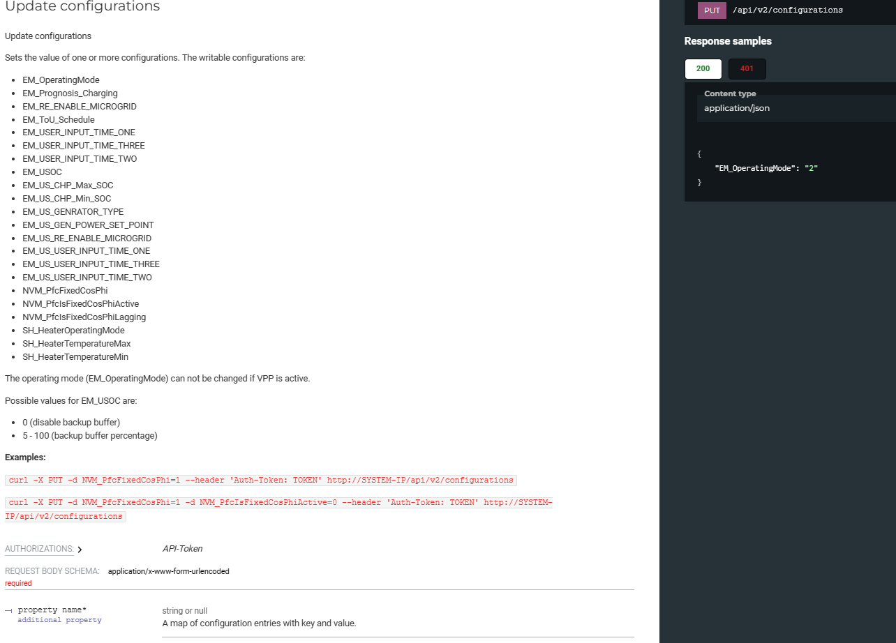

What is this API you are trying to use? Does it have online docs?
No, no online docs. One page of local docs though:
