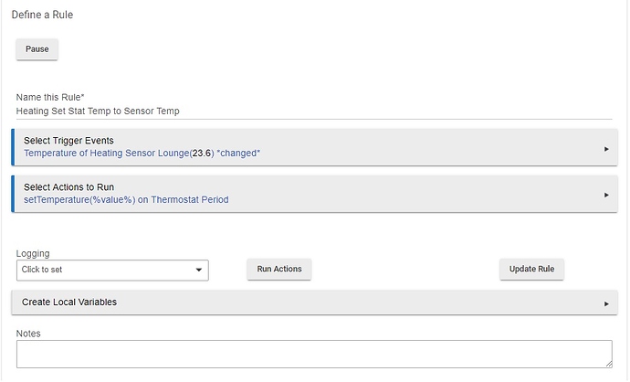

I can confirm that Andy's average all works well, but if you don't want custom code and you only want to sent a single sensor's value to a virtual stat this works in RM4. Make sure you select string for parameter type.
Thank you, that worked perfectly!
I've been trying to do this same thing and having problems, I think I might be missing something. When I create this rule the same way as it appears in your screenshot, %value% gets changed to value() and it doesn't seem to actually use the value from the sensor in the trigger event as the parameter for setTemperature.
I have the same problem as @ardichoke
can someone help to understand this
I misunderstood what I was seeing. If temperature change is the only trigger for your rule, it will populate value() properly the first time it is triggered by a temperature change.
What I ended up doing, because I have a more complex rule that is triggered by multiple things, is set a local variable to the sensor value and then set the virtual thermostat temperature to that variable. Kind of a roundabout way to deal with it, but it works.
