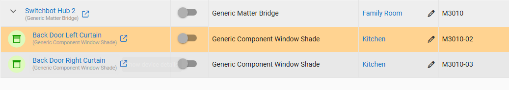

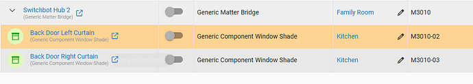

I have a Switchbot Hub 2 with Switchbot Curtains connected via Matter:
The Generic Component Window Shade driver seems to have both 0 and 100 showing as Open for the Windows Shade state.

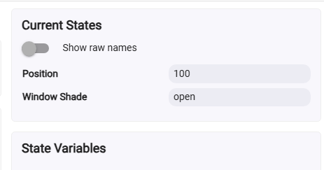

Here's when it's closed:

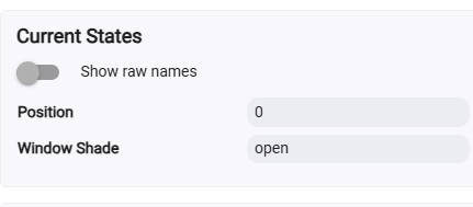

Here's when it's open:
The position attribute is updating correctly but isn't updating the WindowShade attribute correctly show it's it's Closed whenever it's closed. Wasn't sure if this is an issue with this driver, I did remove/readded the Switchbot Hub in Matter and was able to replicate it again.
