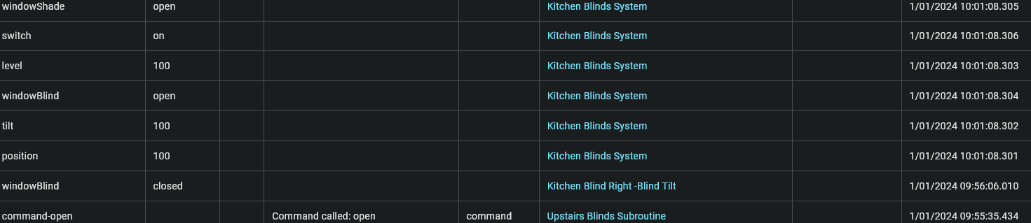

My blinds are working fine since moving the hub but I have a weirdo value I can't explain.
When I set my blinds to 60% from close one of my blinds goes to 60 and one goes to 40.
The Devices page confirms 60/40.
They are both at the same physical position upon inspection. I set the the errant blind to 60 and the motor hums, moves nowhere and stops at the same physical position but now registers as 60.
You can see it gets set in the morning to 60 at 10:34:17 and changes it's mind later on at 12:34:33 after a SetTiltDirection.
All I can figure out it that because the setTiltDirection is not followed by a SetPosition command like the morning command, as it would make no change (a WebCore optimization), the driver possibly send out an uncleared variable becuase it expected a setPosition to follow?

|level|40||||Kitchen Blinds System||1/06/2024 12:34:33.287|
|windowBlind|partially open||||Kitchen Blinds System||1/06/2024 12:34:33.288|
|tilt|40||||Kitchen Blinds System||1/06/2024 12:34:33.287|
|position|40||||Kitchen Blinds System||1/06/2024 12:34:33.286|
|windowBlind|partially open||||Kitchen Blinds System||1/06/2024 12:14:31.270|
|command-setTiltDirection|||Command called: setTiltDirection|command|Upstairs Blinds Subroutine||1/06/2024 12:00:12.521|
|windowBlind|partially open||||Kitchen Blinds System||1/06/2024 11:54:29.349|
|switch|on||||Kitchen Blind Right -Blind Tilt||1/06/2024 10:34:17.198|
|windowShade|partially open||||Kitchen Blind Right -Blind Tilt||1/06/2024 10:34:17.184|
|level|60||||Kitchen Blind Right -Blind Tilt||1/06/2024 10:34:17.181|
|tilt|60||||Kitchen Blind Right -Blind Tilt||1/06/2024 10:34:17.180|
|windowShade|unknown||||Kitchen Blind Right -Blind Tilt||1/06/2024 10:34:13.913|
|position|60||||Kitchen Blind Right -Blind Tilt||1/06/2024 10:34:17.179|
Check the device pages for the two blinds - do they have the same 'Start Position Change' values? Both open or both close? Are they both 60% Open or 60% Closed?
StartPositionChange both say Open.
They were both closed UP this morning.
WC issued an Open command, Right opened to 100% and Left opened to 68%, WTF :slight_smile:
There are a few attributes I have never messed with as it all seemed straight forward.
How does StartPositionChange affect an Open command?
Edit:
My blinds adjust every hour and the next time it adjusted at 10:00 and Open command went out and the errant 68% went to 100%. Again the motor started up and shutdown without moving the blinds physically as they were already horizontal at 100%.
