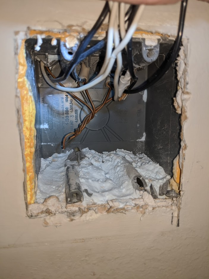

Every box in my house looks like this. They just connected all the grounds together and none of the switches are connected.
Wow. That's crazy. I'm curious as to how that snow got in the box too...lol
But you really need to run a copper pigtail from that bundle of ground wires to each switch.

In this situation, do not separate those grounds. Just add another pigtail to that bundle.
Exactly how the wiring in my house is as well. One of those is ground. The others become ground by being in the same bundle.
EDIT- Just pigtail it.
Also - Is that gang box plastic or metal? If it's metal you may have signal issues but may not.
That's a really old way of doing it at the box and not at back at the panel.... maybe not old but lazy :slight_smile:
Agreed. But that's the situation in a few boxes in my house .....
If that's even a possible case in this situation... I changed my response to "just pigtail it" no use fussing trying to determine the correct ground (even though they should all be ground!!!)
Wow. I have a 1978 house, and even it has all the grounds with pig-tails. We had a '72 condo that had a few 2 wire boxes (no ground), but I was force to pull a ground for those when we sold the house.

My house was built in 1991. My FIL says it's very common for switches to not be connected to the ground. Also, it's a plastic box, not metal. It's just grey colored.
