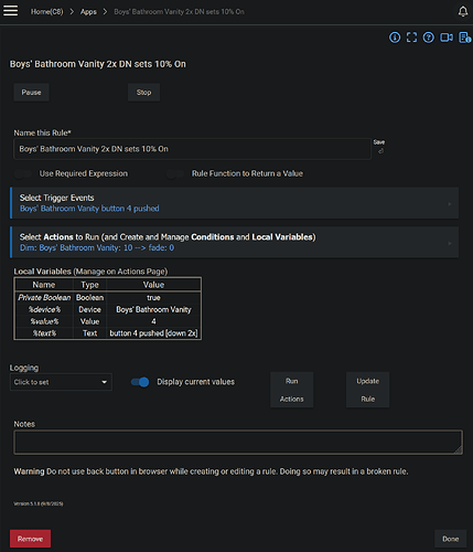

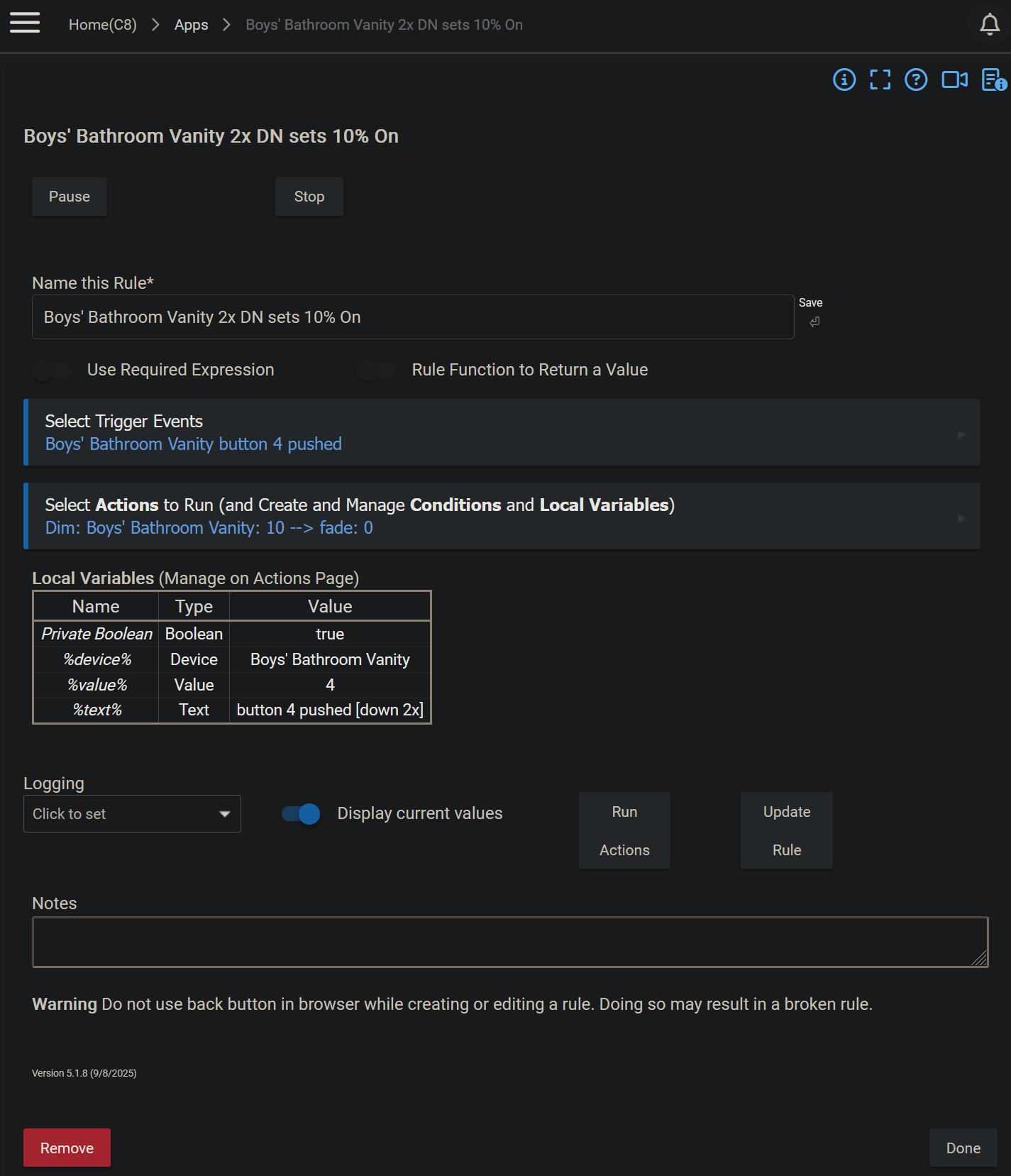

As for the automations themselves, they're fairly straightforward Rule Machine 5.1 rules for multi-tap gestures on my Zooz, GE, and Inovelli wall switches. Here's a sample of one of them:
I can reliably reproduce the issue by rebooting the hub. I'm now trying to more formally test what, exactly, happens in the logs when the multi-tab gesture is pressed on the switch after a hub reboot. My recollection is that the first time the gesture is executed, the logs show the button press, but the lights don't turn (which implies to me that the RM rule isn't firing and this is a hub issue). The second time the gesture is executed, the logs show the same entries for the button press, and the rule actually fires and the lights go to the correct level.
