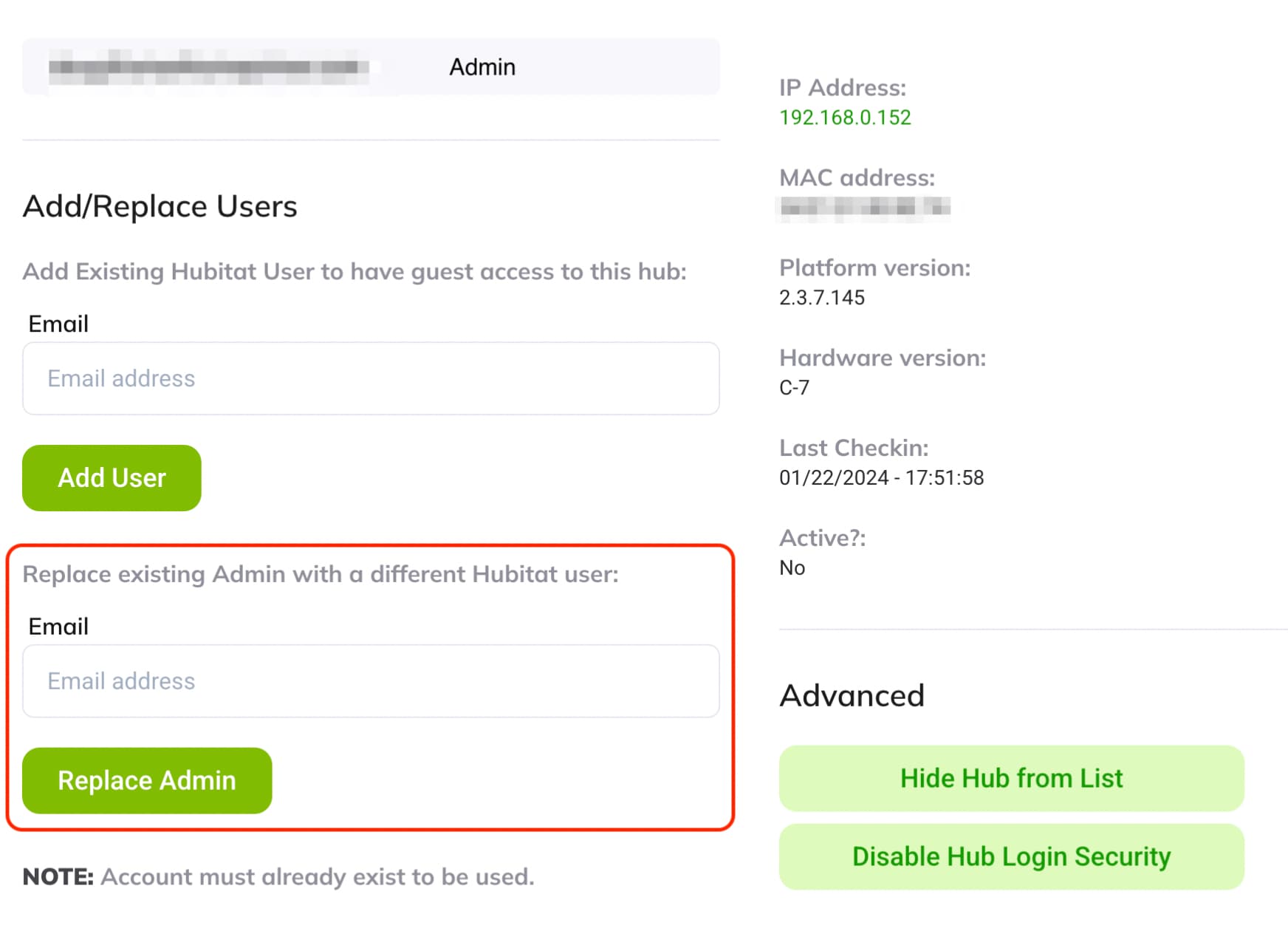

I'm trying to change the email associated with my hub's admin account. I have created and verified my new account but when I try to swap admins on the hub, I get a "User not found" message. Even though I can log into the new account at my.hubitat.com

Did you follow these steps? The document primarily focuses on how to add a guest user, but it directs you to where you need to be to replace the user account on the hub.
Yes.
I'm not trying to add a guest but swap admin accounts on the hub.

I just tried it on one of my hubs that is registerd, but I'm not using right now. I was able to swap the user with my Hubitat account that I only use for the forum, and the hub disappeared from the list, just as expected.
I logged out of my hub admin account and logged in with the account that I swapped the hub to, and it was there in the list by itself as expected. I then swapped it back to my hub admin account and received a "No registered hubs found" message (or something to that effect). This was of course the correct message to display.
I then logged back in with my hub admin account and all 3 hubs were there again.

Make sure that the new accout is not also the guest on the hub. There is a known issue that some users receive the "User not found" message that we are still investigating, and having the guest on the account is one incident when that error occurs.
I have no users on the hub other than my admin account.
