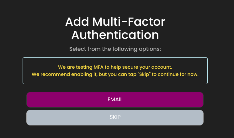

@craigde Heads up - GE/Brillion has made a change to the login process that is going to break everyone’s connection the next time the app tries to reauthenticate. I found this because I connect both via HE and HA, and my HA connection broke first.
The issue seems to be that they added a step to the login process. If you login via the website you get this after entering your username and password:
Skipping is not persistent, so even if you skip, you get prompted again on the next login. I’ve already emailed support to ask them to rethink this process and asked if they would consider making the skip set a flag on the account so subsequent logins would not hit this prompt.
I don’t want to activate MFA right now since my HE integration is still working, so I don’t know what they logon process will look like with MFA enabled. From looking at my account settings, it looks like it would send me an email with the code. Going forward, if they don’t implement a token system for integrations or allow users to opt out of MFA, this is going to be a pain as it will require manual intervention every time the app needs to reauth.

Still no luck for me. It looks like they turned on the ‘we are testing MFA’ step again.
I worked with Claude to make it work with the MFA nag screen. I forked your code and did a pull request with the modified smartHQ_app
I also sent support another email asking them to consider third-party integrations when making changes to their logon process. Maybe they’ll remove the nag screen again.
The auto-generated name for the PR is “Refactor get_authorization_code with MFA support#12” but it really doesn’t add MFA support, it just adds support for bypassing the MFA testing prompt.

  • GE's "we're testing MFA" prompt is now skipped automatically, so logins go through without you doing anything.
  • The crash that was killing reauth (ArrayIndexOutOfBoundsException) is fixed — GE had changed their login redirect and it tripped up the old code.
Big thanks to @youzer-name for working out the MFA skip on a live account
