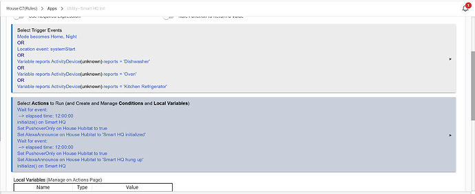

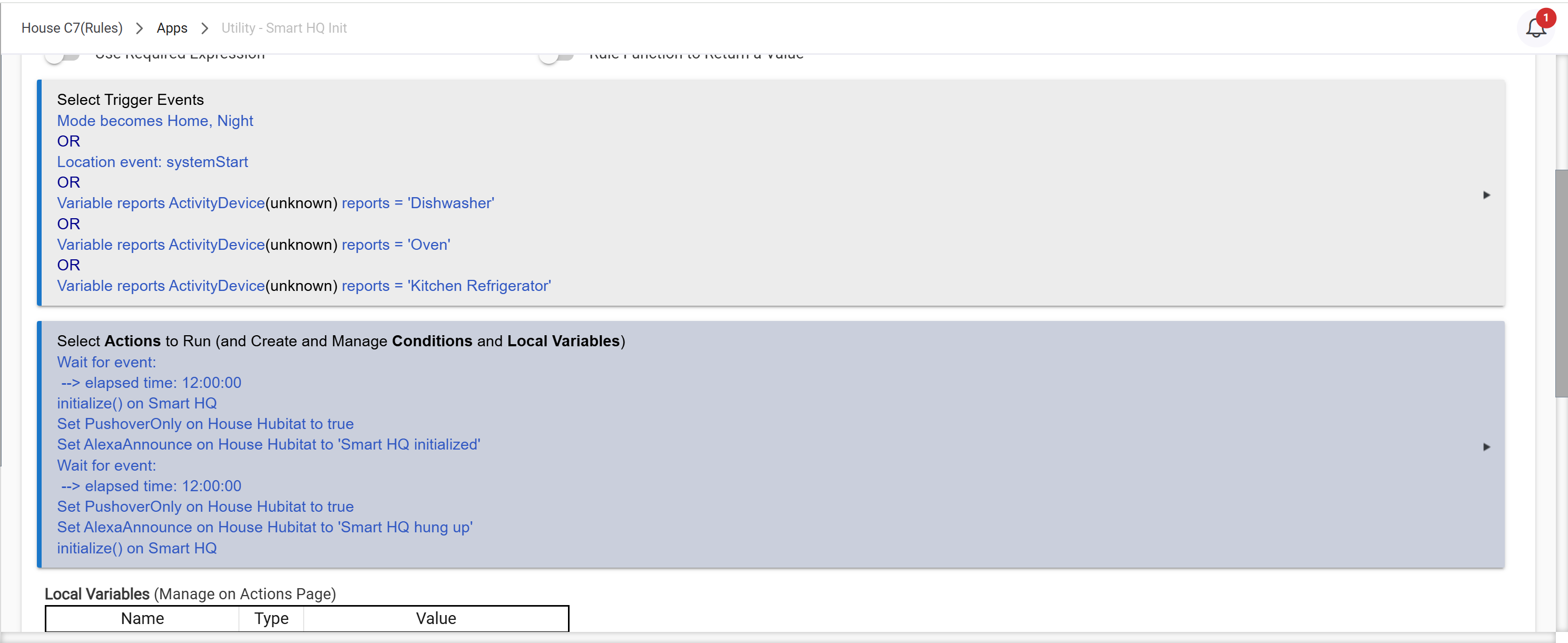

I am using the Smart HQ plugin. Works great most of the time. However, it goes offline once a week. All I do is refresh SmartHQ and works fine again. However, this shouldn’t happen this often. Any ideas or fixes?
Thank you
I have the same issue. I made a rule that if no Smart HQ device updates in a 12 hour window then it will do Smart HQ init.
This was an issue in the past and I thought it had been addressed in the driver, but I have been seeing this lately as well. I just added the rule and so far it's been good enough.
Thank you so much. Would you mind sharing your script?

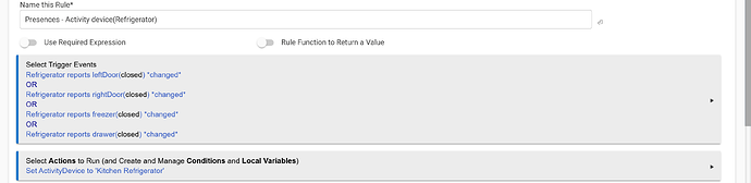

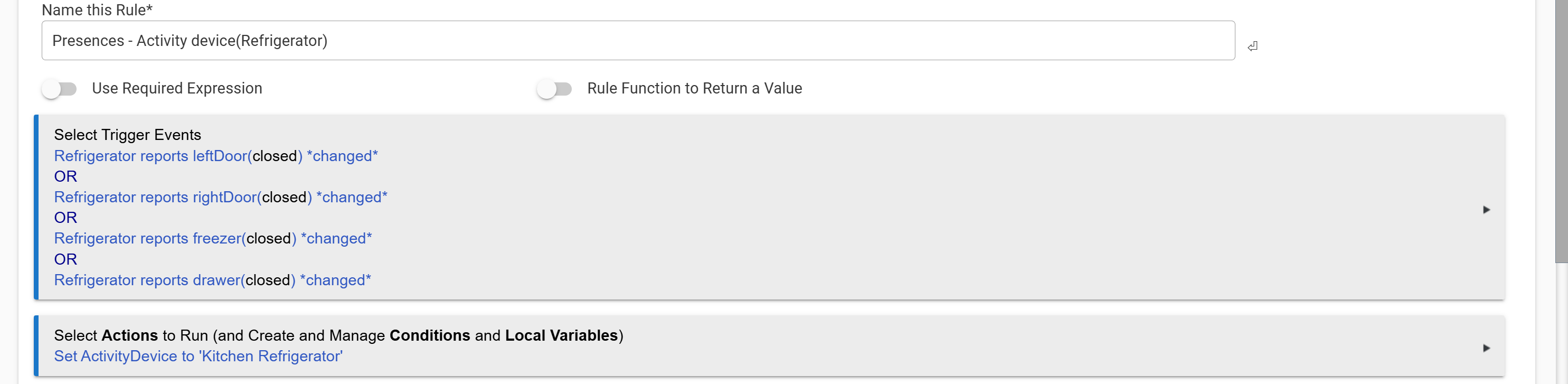

The rule uses other hub variables and rules so it might not be clear what it is doing.
Basically the deviceactivity variables trigger the rule when I use some function of a Smart HQ device. Once a device is used it triggers the rule and it waits 12 hours. Each time a trigger occurs the 12 hour wait starts over. If no activity on a Smart HQ device then it send me a message.
If the second wait doesn't get stopped by a trigger then I get a different message and I know to go manually check to see what is going on. Haven't seen that message yet.

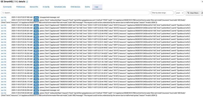

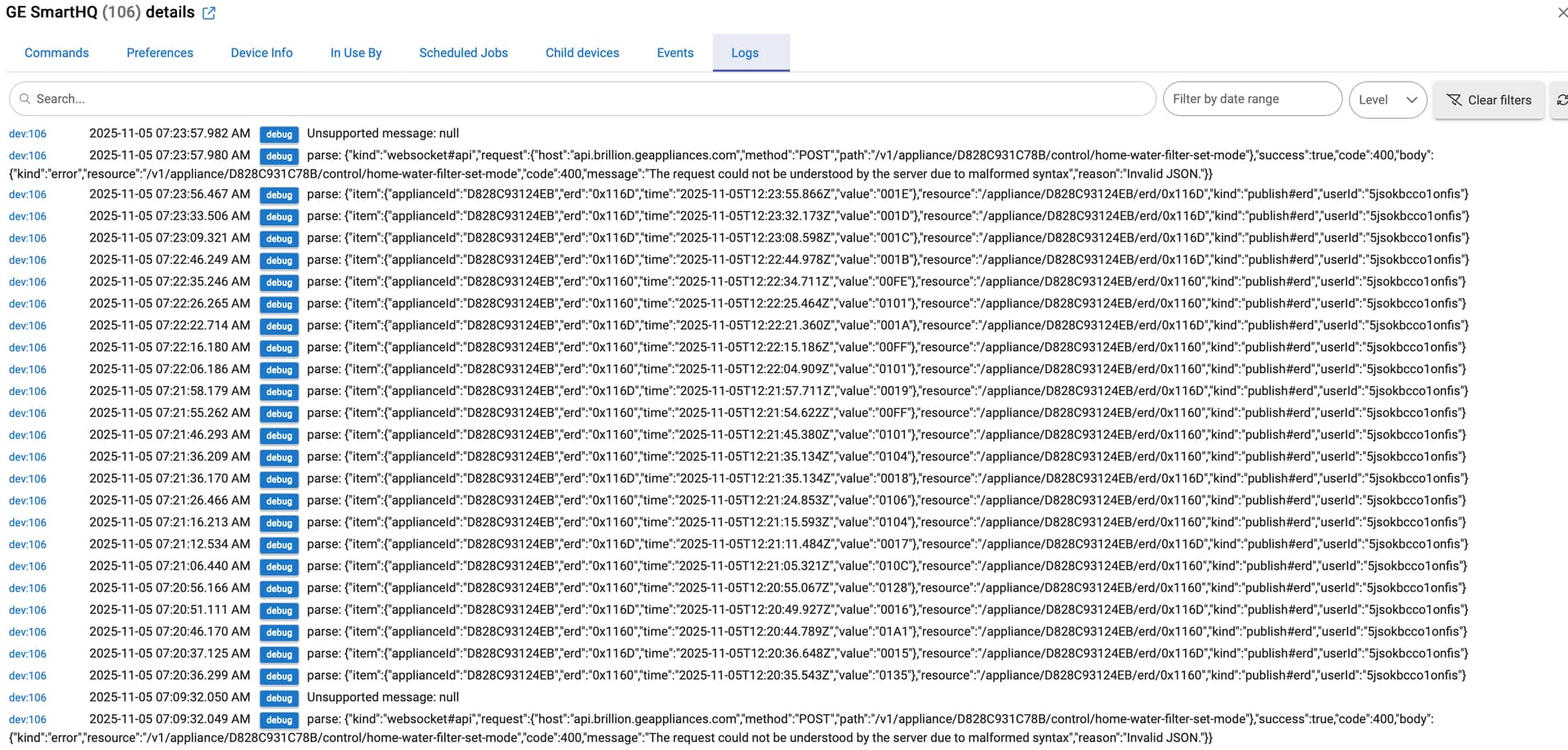

Recently my control of my house water filter has stopped. looking at the logs and it says something about malformed request. Here is a screen shot of the log
