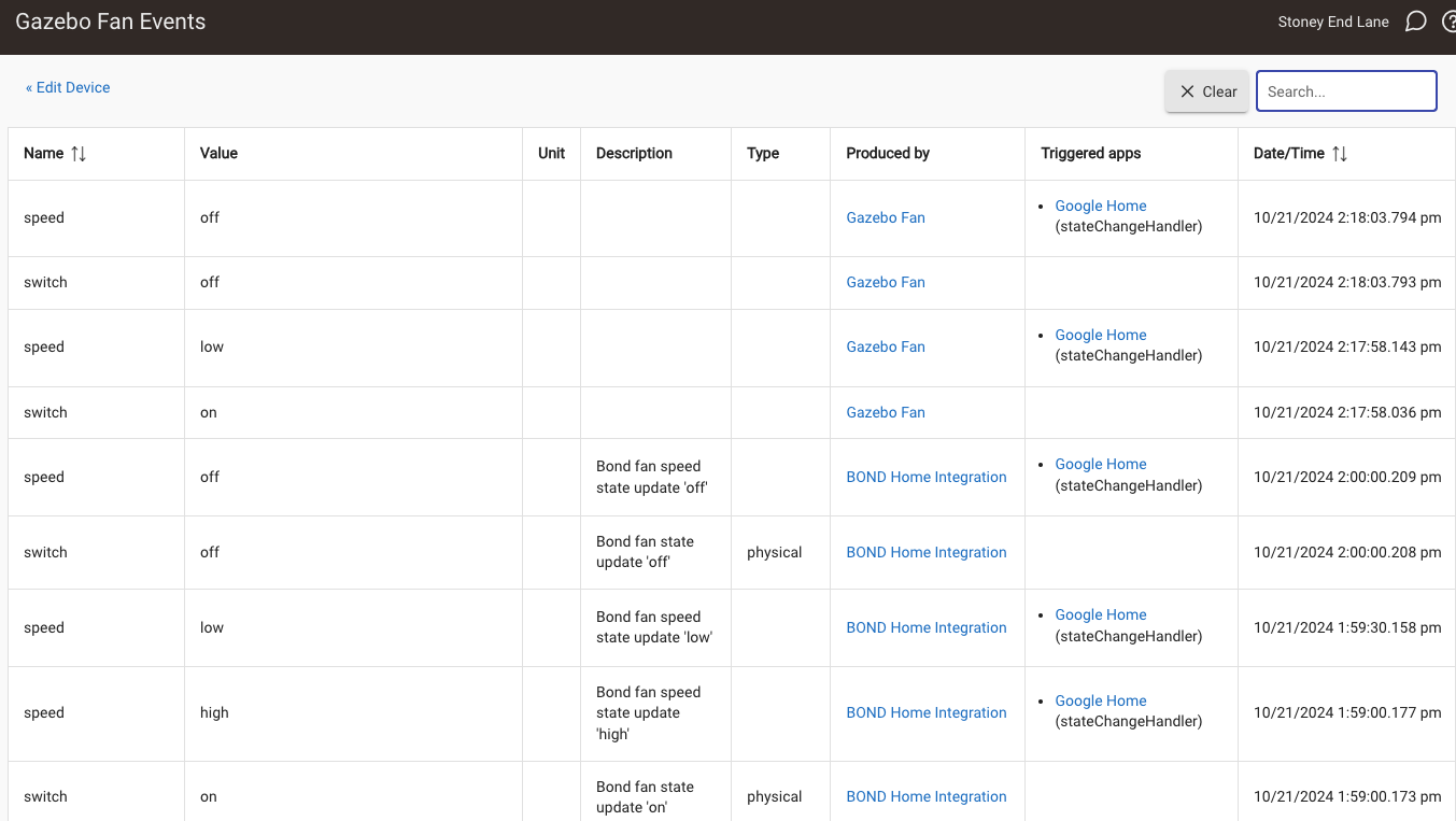

Fixed an issue in the BOND Home Integration app code that was not properly updating a fan's light device's status in Hubitat when the device was operated using the Bond native (local) control.
Because the bug was in the core app code, this requires updating your installed instance of app code instead of creating a new file and switching to it like as with drivers.
Get the updated code here: BOND_Home_Integration.groovy
Open up BOND Home Integration under Apps code and replace the entire code base with the code from my file linked above. Once you have save the update, go to each instance of BOND Home Integration under Apps and click Next, Next, Done to reload the code base.
You may or may not see [error] getDeviceById: 404 - null in the logs. If only seen when you perform the app reload, it can safely be ignored.
The app, by default, pulls the latest Bond device state every thirty seconds (you can change the interval in the app configuration). So changes to the device using the native/local Bond interface will be reflected in the light driver state within 30 seconds of any change. This will keep the Hubitat driver in sync with the light and also facilitate proper behavior with other apps that monitor and react to device driver state such as Rule Machine and Switch Bindings 2.0.

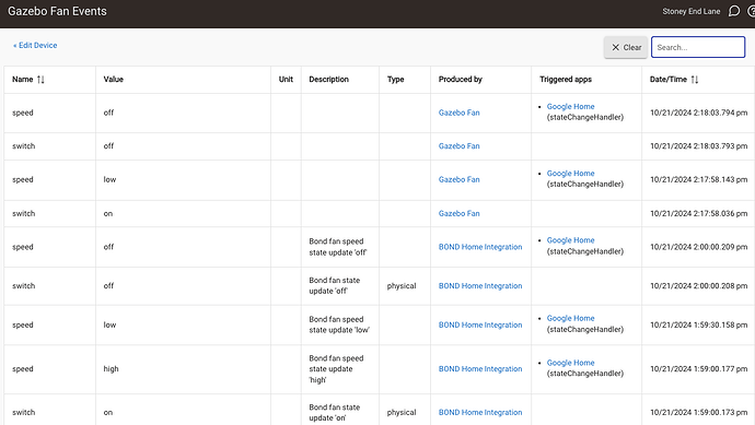

20241021 update to BOND_Home_Integration.groovy
Detected state changes on the Bond controller to power/switch now report as type "physical" which may or may not be useful to you for apps such as Rule Machine where you may want to act differently on physical vs digital events.
Events triggered by human interaction with the Bond drivers (device interface in Hubitat), for now, should show up as type empty ("") or null. They may still distinguished from non-human events such as those triggered by Rules and and other Hubitat apps which may report as type "command".

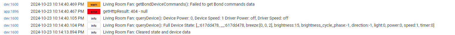

Don't know that it finished up properly, got a NPE in the logs:

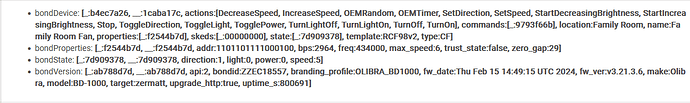

But here's the data section:
I made an incorrect assumption about Bond fans having Breeze support, yours does not. Although I do see an "OEMRandom" in the bondDevice that might be a Breeze like feature. I'll poke at that later if you are so inclined.

In the interest in trying to be helpful, I'm running the same BOND Fan With Direction, so I followed your instructions with your BOND Fan With Direction v2 and this is what I see with the original App code (without your modifications):

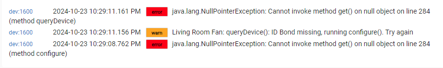

With your App code modifications, I get the following when following your instructions above, however I did append a "2" on the name of the modified app.
Thank you.
The Failed to get Bond commands data warning is expected, I'll update the message to indicate that. Apparently that API endpoint is specific to certain types of Bond controllers.
Can you look at the v2 driver code you have and confirm for me that line 284 is:
maxSpeedN = parent.state.fanProperties.get( devId ).get( "max_speed" )
If so can you screen shot for me your BOND Home Integration Application State? In Apps, click the gear icon left of the app, or go into the app and click the gear icon in the upper right. Then scroll down.
