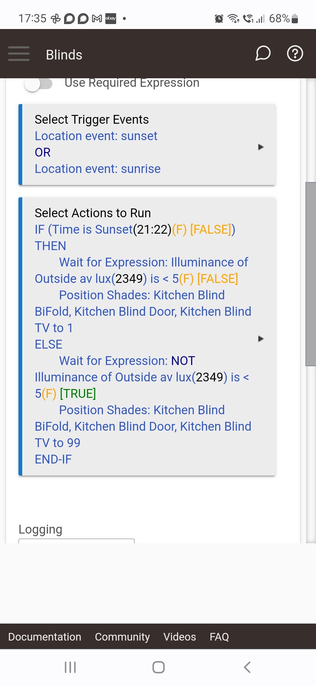

it was for operating my blinds, so close open and dawn/dusk, using lux < or > would cause a rule to run evey time the lux changed and my override a manual operation.
eg if i close them during the day, nothing will override them at the moment until sunrise the next day, or if the partly closed the will fully close at sunset. id like to use twilight like sunset etc

Could use the trigger as sunset then wait for lux 10
