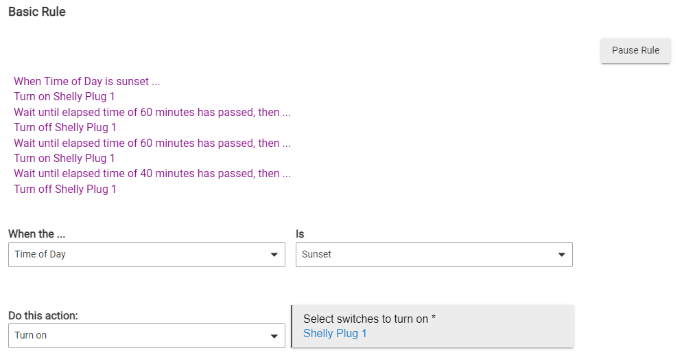

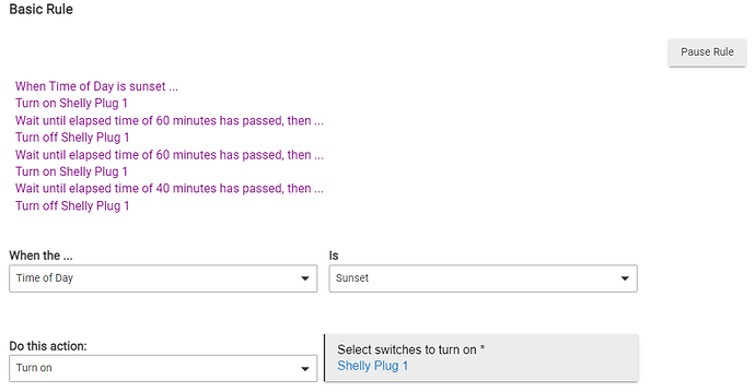

I've created the basic rule below to turn a Zwave plug on at sunset for 60 minutes, wait 60 and then turn on again for 40. I'm running C-7 2.3.5.125, this rule works fine if I set a specific start time, it just does not work with Sunset as a trigger.
I'm still not very fluent with troubleshooting Hubitat but looking thru various logs and events I can find no hint of errors or attempted execution/trigger happening at sunset.
I've seen other posts say to look at the App Status page and I see 'No event subscriptions are set.' here for this basic rule.

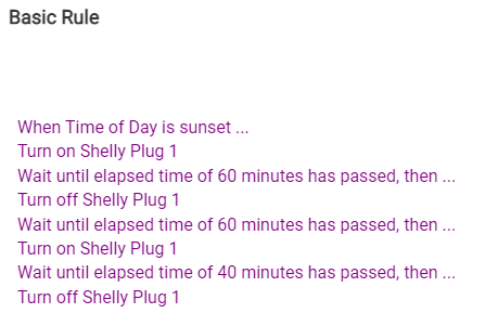

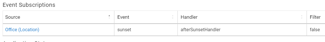

After reading some more posts here I read that events triggered pre/post sunset/sunrise seem to work a bit different than those that act at sunset/sunrise. I changed my rule to trigger 5 minutes after sunset and looked at the app status page and did not see a scheduled event as I suspected I would. I then set the rule back to trigger on Sunset and see this subscription event.

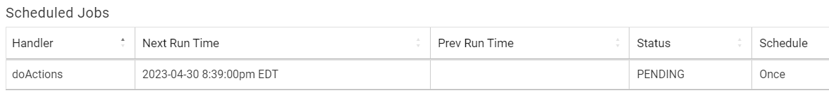

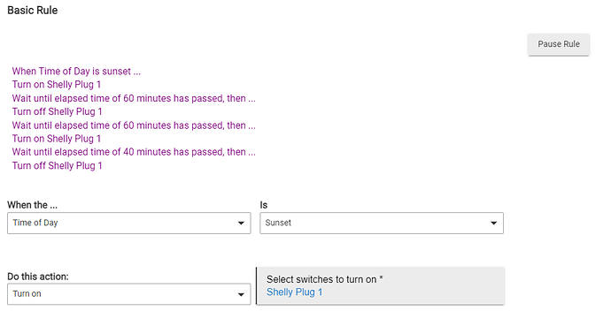

I also see a scheduled job for 5 minutes after sunset. Obviously something odd going on here as this is what I would have expected to see when I set the trigger to run 5 minutes after sunset. Here is the current rule with the event subscription set as above.

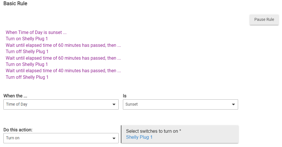

I next changed the event to trigger at a specific time and look at the app status and see no event subscription and a scheduled event for the expected time. I then reset the trigger on the app to be at sunset and go to the app status page and it is back to the 5 minutes after sunset settings.
