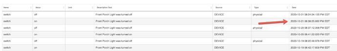

Same here. I also have rules that are firing despite being deleted/paused. Here is one, this device used to have a Mode rule but I had paused it , and eventually deleted it; it doesn't not have any active rule associated with it anymore but it still keeps turning on.

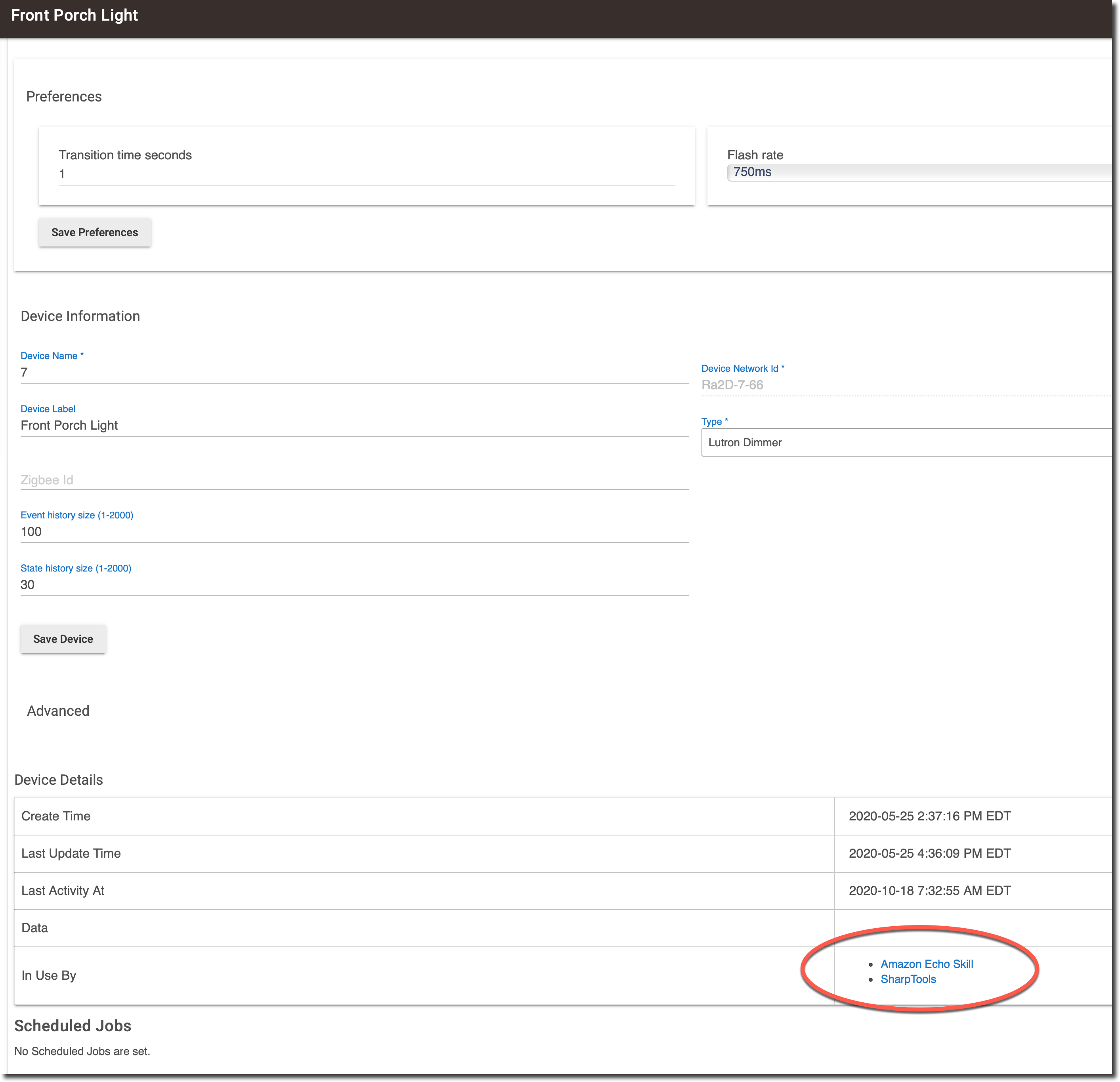

Agreed. Does it come on at a particular time? One way to test the Alexa/Google theory, if you can spot a time window, would be to disconnect your hub from the internet during that window. If light still comes on, then it’s something on your hub. If not, focus on Alexa/Google sources.
No, I do not. These were devices added recently and also rules written exclusively in HE. I have zero routines in Alexa and I don't use google hub for anything (it's actually unplugged).

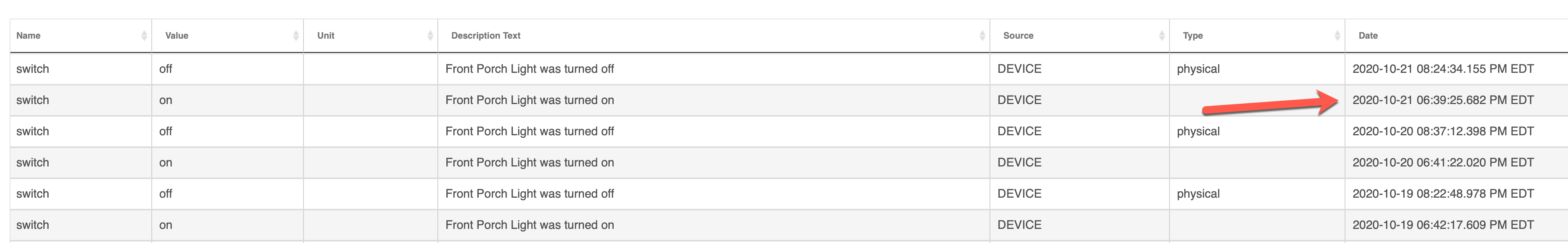

There is no rule anymore. But in the device event logs (screenshot in my previous message) shows device turning on. If you see closely, you will see there is an ‘off’ event as well, some of which are tagged as ‘manual’ because I am turning it off manually from the switch. It’s a Lutron Dimmer switch. If I don’t turn off it will eventually turn off in the morning because the (now deleted) rule was configured to act based on Sunset/Sunrise timings.
This is one example of erratic rule. I have others (some of those documented in this thread earlier) that have stopped working randomly.

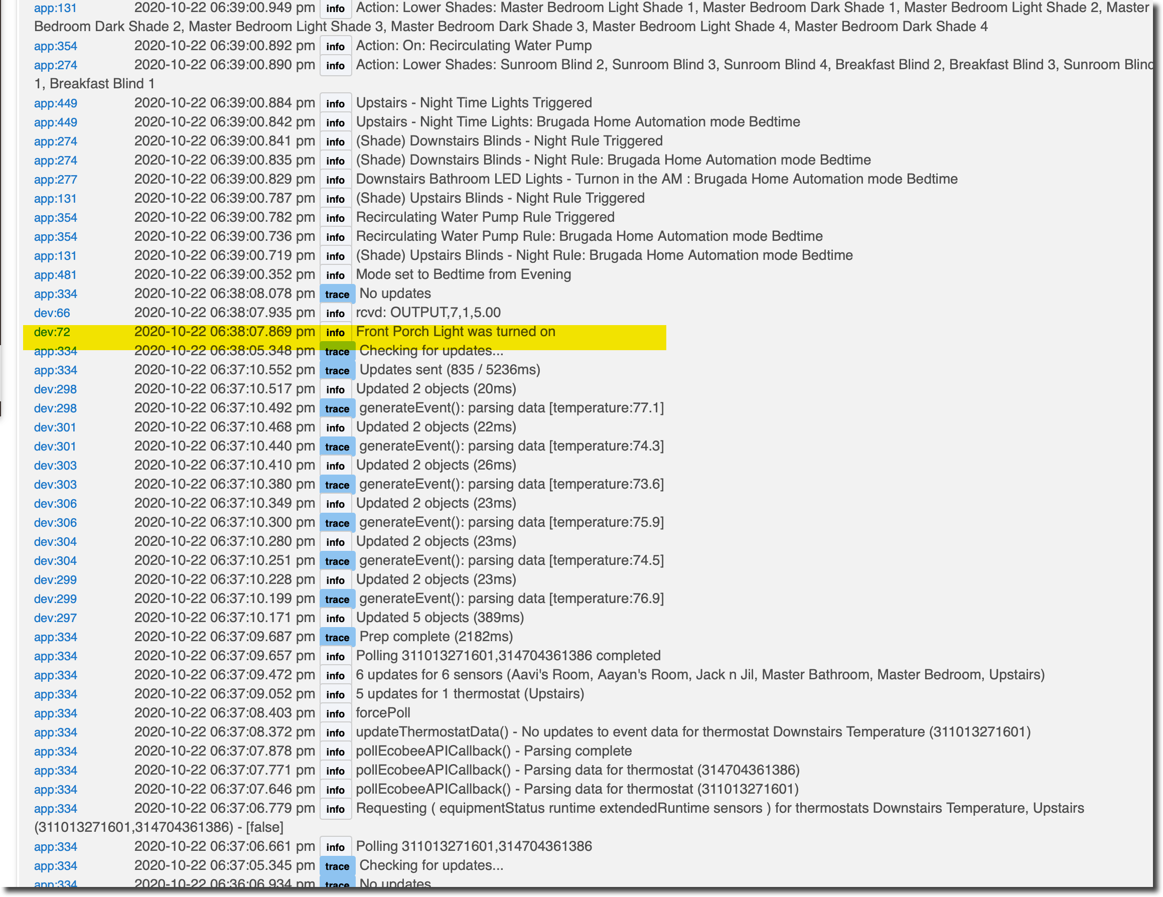

I saw your device event logs and I understand what you are saying. That doesn’t address my question about the system logs showing events happening before this switch turns on. It’s also possible that your database has somehow become corrupted. Have you tried taking a backup (which backs up the good stuff), doing a soft reset, and restoring the backup database?
I only see switch turning off in system log trail. But it could unfortunately could also be due that ‘cos logs rotated. I’ll try to grab it tomorrow. I haven’t tried restoring from backup. Maybe that’s the next step.
Waited today to capture the logs on time. The light turned on at Sunset (as expected) albeit a few seconds prior. Sunset was 6:39pm per 'Location' setting and lights turned on a few micro seconds earlier. But nothing weird on/off events within the vicinity of this lights events.
