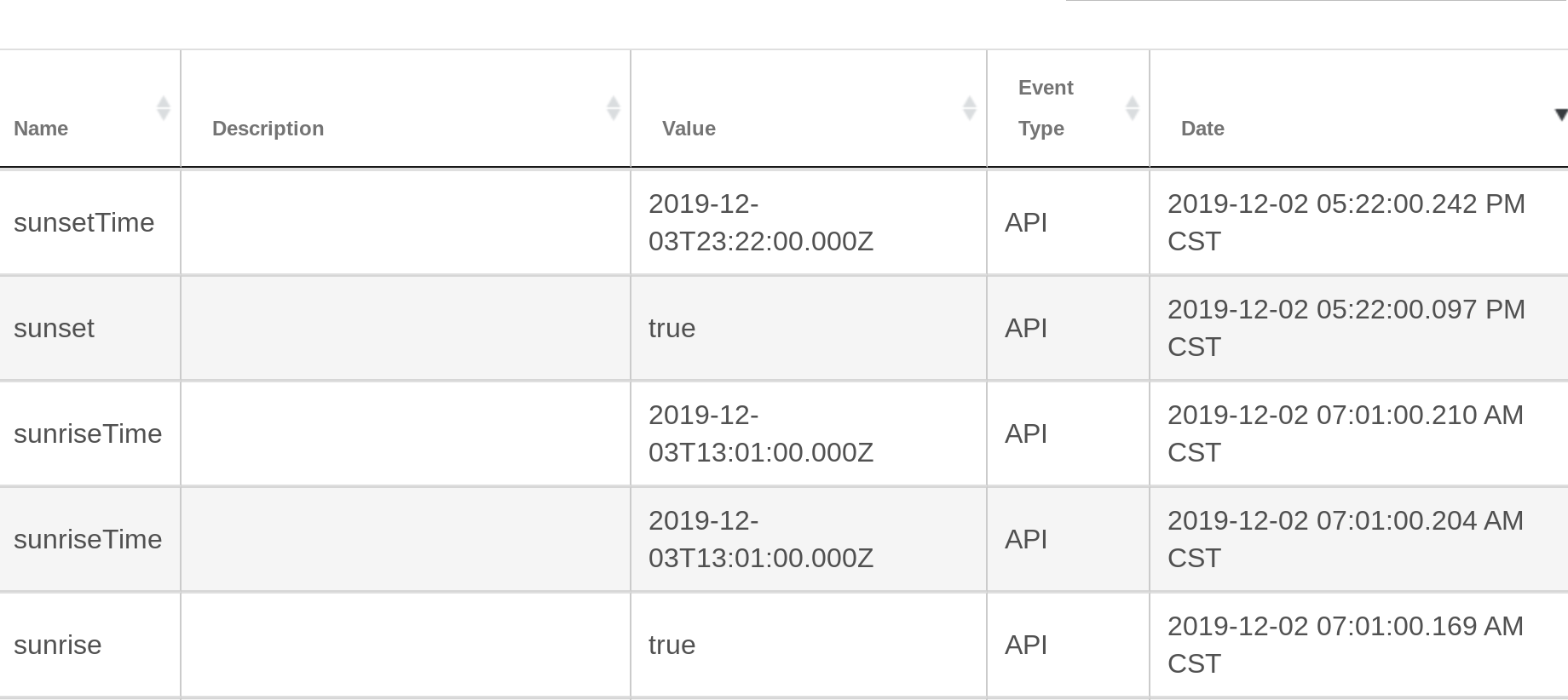

I checked the settings-> hub details- it has a current time. image

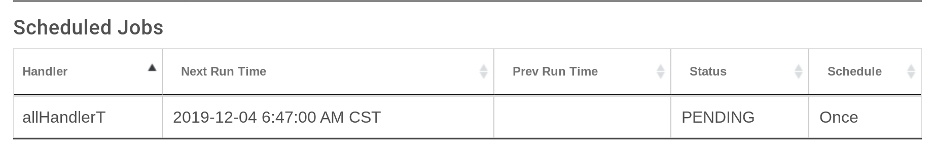

I finally had to do an "update rule" to get a scheduled event setup
