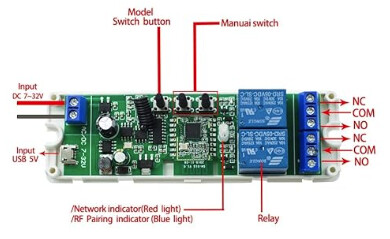

For zigbee use an MHCozy (they come in multiple channel as well for multi garage doors) $20.00 (for 2 channel)

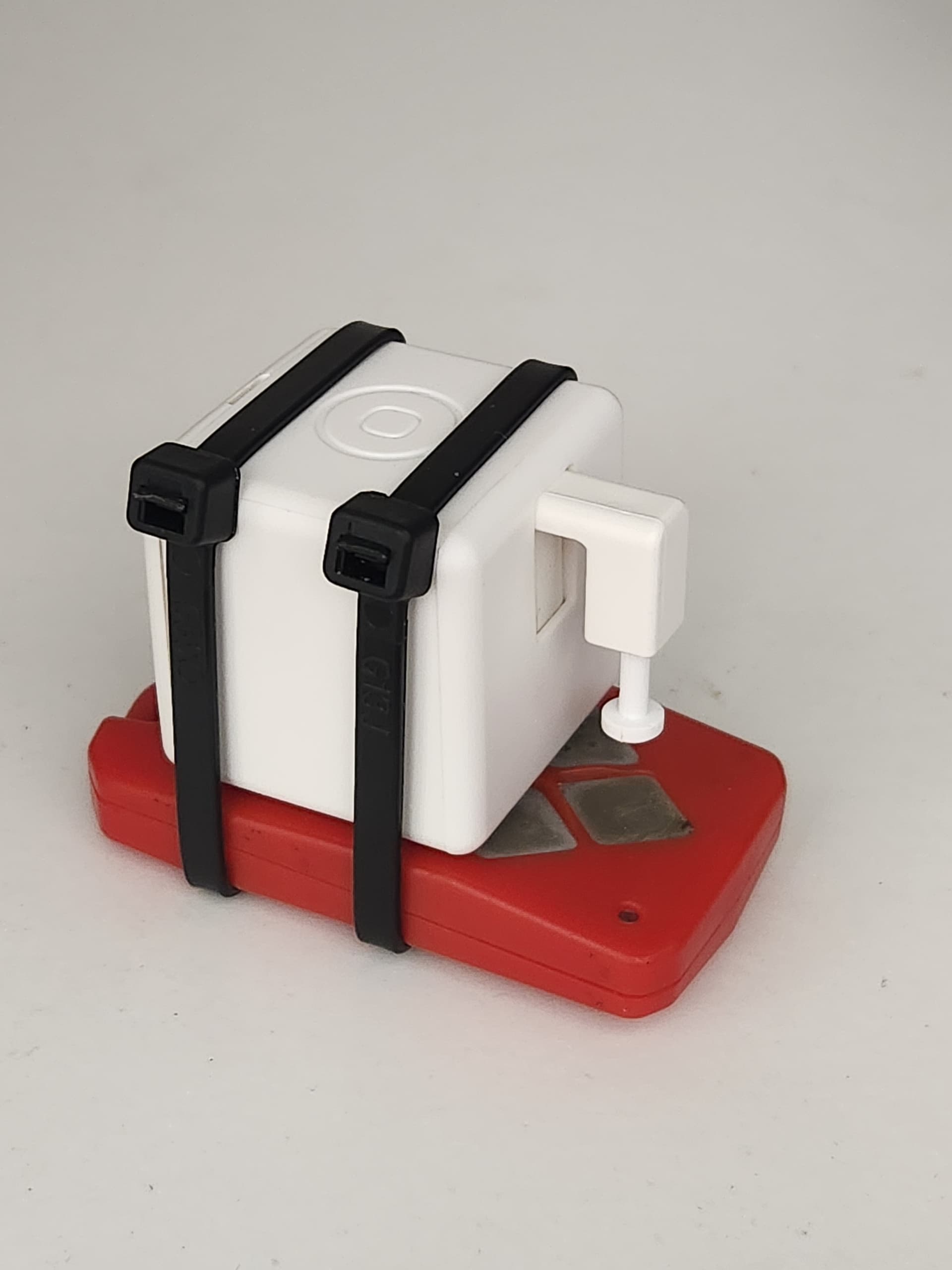

I use a zigbee fingerbot, an old remote fob and a sonoff contact sensor. It's cheap easy (no wiring) and works every time for me.
