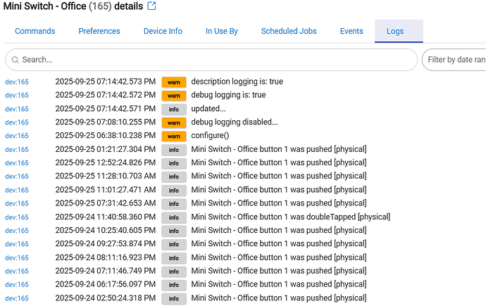

Suddenly 2 out of 3 Aqara mini switches stopped working. The one shown below won't even register a key being pushed. No other indications of a problem. I tried rebooting the Hubitat, rebooting the Zigbee radios, and rebuilding the Zigbee database. FYI I just updated to version 2.4.3.123 yesterday.
Anything else I could try before factory resetting these buttons?
-Thanks
The logs show the same thing that a button press was not registered for hours. I enabled debug logging and pressed the button a few times and it still did not register a log entry.
